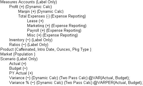

This example includes a calculation of the variance percentage between Budget and Actual values.
Figure 135, Variance and Variance % in the Scenario Dimension shows an outline in which Variance and Variance % are tagged as Dynamic Calc, two-pass members.
During a default calculation, Essbase aggregates the values on the Market and Product dimensions. Because percentage values do not aggregate correctly, the Variance % formula must be recalculated after the default calculation.
Because Variance % is tagged as a Dynamic Calc, two-pass member, Essbase dynamically calculates Variance % values when they are retrieved. The dynamic calculation overwrites the incorrect values with the correctly calculated percentages.
If you choose not to tag Variance % as a Dynamic Calc, two-pass member, use the following calculation script—which assumes that Intelligent Calculation is turned on (the default)—to perform a default calculation and to recalculate the formula on Variance %:
CALC ALL; SET UPDATECALC OFF; SET CLEARUPDATESTATUS AFTER; "Variance %";
Essbase performs the following actions:
Performs a default calculation of the database (CALC ALL).
Alternatively, you can run a default calculation of the database outline without using a calculation script.
Marks the calculated blocks calculated by the variance formula of the calculation script as clean, even though the variance calculation is a partial calculation of the database (CLEARUPDATESTATUS AFTER).
By default, data blocks are marked as clean only after a full calculation of the database.
Cycles through the database calculating the formula for Variance %.
See Choosing Two-Pass Calculation Tag or Calculation Script and Using Two-Pass Calculation.
For information on calculating statistical variance, see the Oracle Essbase Technical Reference.

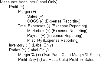

As shown in the outline in Figure 138, Measures Dimension, assume that no members are tagged as Dynamic Calc, and that the Profit per Ounce member (under Ratios in the Measures dimension) is not included in the calculation.
Assume that, before running the goal-seeking calculation script, the data values are:
Product, Market, Budget Jan
Profit 12,278.50
Margin 30,195.50
Sales 49,950.00
COGS 19,755.00
Total Expenses 17,917.00
Marketing 3,515.00
Payroll 14,402.00
Misc 0
Inventory Label Only member
Ratios Label Only member
Margin % 60.45

Essbase performs the following calculations:
Declares the required temporary variables using the VAR command. Where appropriate, the initial values are set.
Declares a one-dimensional array called Rollback to store the Budget values.
The size of Rollback is based on the number of members in the Measures dimension.

The results for product 100-10:
Profit 15,000.00
Margin 32,917.00
Sales 52,671.50
COGS 19,755.00
Marketing 3,515.00
Payroll 14,402.00
Misc 0
Margin % 28.47839913
Profit % 62.49489762This example uses a linear regression forecasting method to produce a trend (@TREND), or line, that starts with the known data values from selected previous months and continues with forecasted values based on the known values, and shows how to check the results of the trend for “goodness of fit” to the known data values. In this case, the calculation script forecasts sales data for June–December, assuming that data currently exists only up to May.
