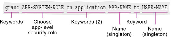

MaxL statements begin with a verb, such as create or alter, which indicates the type of operation to perform. Then you specify an artifact, such as database or user, which indicates the Essbase elements you are working with. The rest of the statement provides details about the action to perform, using a grammatically correct sequence of statement parts, or tokens.
For an overall picture of grammar requirements and the verb-artifact structure of MaxL statements, see the MaxL DDL section of the Oracle Essbase Technical Reference.

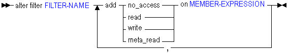

The MaxL parser expects to see MaxL keywords and other tokens in their correct grammatical order, as diagrammed in MaxL topics in the Oracle Essbase Technical Reference.
Figure 150, Example of MaxL Syntax Diagram: Alter Filter shows a sample syntax diagram from the Oracle Essbase Technical Reference. Only the lowercase words in the diagram represent keywords. The other elements are placeholders for names or values that you provide.
