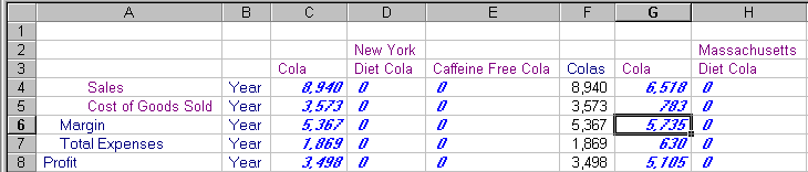

    In this example, the sample drill-through report is associated with every member intersection at the state level in the East region, so that all data cells associated with an Eastern state and children of Cola are now displayed in blue, bold, italic font.
    Market Detail worksheet of the Sample Basic database in Excel.
  To access the sample drill-through report from Spreadsheet Add-in:
  1. Select a drill-through cell; for example, cell G6.
