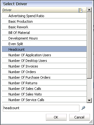

    The Select Member dialog box opens, showing all available members.
  2. Expand the member list, and select the member.
    To search for a member, type the member name in the text box at the bottom of the dialog box and click the Search button Search Button.
    Common Member Selector dialog box
