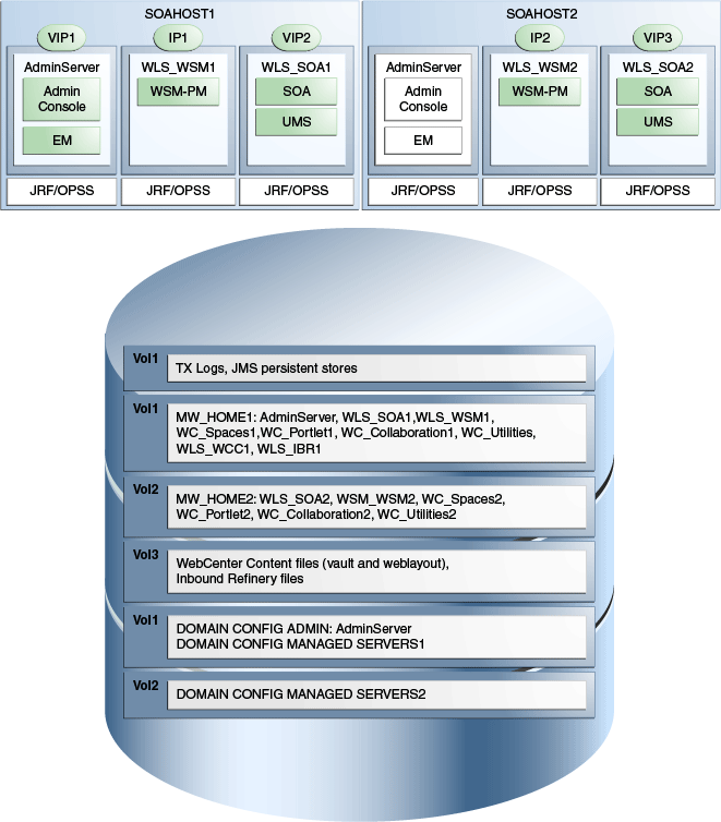

Figure 4-1 shows this directory structure in a diagram. <note that web
The directory structure in Figure 4-1 does not show other required internal directories, such as oracle_common and jrockit.
Table 4-1 explains what the various color-coded elements in the diagram mean.

Figure 4-2 shows an example configuration for shared storage with multiple volumes for WebCenter Portal. The example shows SOAHOST1 and SOAHOST2. In addition, managed server directories on WCPHOST1 and WCPHOST2 appear on VOL1 and VOL2 as shown.
Table 4-2 summarizes the directory structure for the domain. In the table:
WLS_WCP refers to all the WebCenter Portal managed servers: WC_Spaces, WC_Portlet, WC_Utilities, WC_Collaboration
WLS_WCC refers to the WebCenter Content managed server WLS_WCC, and includes WLS_IBR.
Table 4-2 Content of Shared Storage

From SOAHOST2 and WCPHOST2:
mount nasfiler:/vol/vol2/ORACLE_BASE/product/fmw ORACLE_BASE/product/fmw -t nfs
If only one volume is available, users can provide redundancy for the binaries by using two different directories in the shared storage and mounting them to the same directory in the SOA Servers:
From SOAHOST1:
mount nasfiler:/vol/vol1/ORACLE_BASE/product/fmw1 ORACLE_BASE/product/fmw -t nfs
From SOAHOST2:
mount nasfiler:/vol/vol1/ORACLE_BASE/product/fmw2 ORACLE_BASE/product/fmw -t nfs
The following commands show how to share the SOA TX logs location across different nodes:
mount nasfiler:/vol/vol1/ORACLE_BASE/stores/soadomain/soa_cluster/tlogs ORACLE_BASE/stores/soadomain/soa_cluster/tlogs -t nfs mount nasfiler:/vol/vol1/ORACLE_BASE/stores/soadomain/soa_cluster/tlogs ORACLE_BASE/stores/soadomain/soa_cluster/tlogs -t nfs
From WCPHOST1 and WCPHOST2:
The following commands show how to share WebCenter Content and Inbound Refinery files across different nodes:
mount nasfiler:/vol/vol3/ORACLE_BASE/admin/wcdomain/wcc_cluster/vault -t nfs -o rw,bg,hard,vers=3,nolock mount nasfiler:/vol/vol3/ORACLE_BASE/admin/wcdomain/ibr_cluster/ nfs -o rw,bg,hard,vers=3,nolock
And likewise for WCPHOST2.
Validating the Shared Storage Configuration
Ensure that you can read and write files to the newly mounted directories by creating a test file in the shared storage location you just configured.
For example:
$ cd newly mounted directory
$ touch testfile
Verify that the owner and permissions are correct:
$ ls -l testfile
Then remove the file:
$ rm testfile
The shared storage can be a NAS or SAN device. The following illustrates an example of creating storage for a NAS device from SOAHOST1. The options may differ depending on the specific storage device.
mount nasfiler:/vol/vol1/fmw11shared ORACLE_BASE/wls -t nfs -o rw,bg,hard,nointr,tcp,vers=3,timeo=300,rsize=32768,wsize=32768
Contact your storage vendor and machine administrator for the correct options for your environment.
