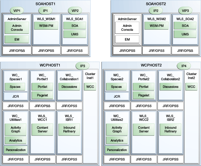

Configure the Administration Server and the managed servers to listen on different virtual IPs and physical IPs as illustrated in Figure 3-1. As shown in this figure, each VIP and IP is attached to the WebLogic server that uses it. VIP1 is failed manually to restart the Administration Server in SOAHOST2. VIP2 and VIP3 fail over from SOAHOST1 to SOAHOST2 and from SOAHOST2 to SOAHOST1 respectively through Oracle WebLogic Server Migration feature. See Oracle Fusion Middleware High Availability Guide for information on the WebLogic Server Migration feature.
Physical IPs (non virtual) are fixed to each node:
IP1 is the physical IP of SOAHOST1 and is used by the WLS_WSM1 WebServices Policy Manager server.
IP2 is the physical IP of SOAHOST2 and is used by the WLS_WSM2 WebServices Policy Manager server.
IP3 is the physical IP of WCPHOST1 and is used by all the WebCenter Portal servers (WC_Spaces1, WC_Portlets1, WC_Collaboration1, WC_Utilities1 and ClusterInst1.
IP4 is the physical IP of WCPHOST2 and is used by all the WebCenter Portal servers (WC_Spaces2, WC_Portlets2, WC_Collaboration2, WC_Utilities2 and ClusterInst2.
Table 3-1 provides descriptions of the various virtual hosts.
Table 3-1 Virtual Hosts
Virtual IP | VIP Maps to... | Description |
VIP1 |
ADMINVHN |
ADMINVHN is the virtual host name that is the listen address for the Administration Server and fails over with manual failover of the Administration Server. It is enabled on the node where the Administration Server process is running (SOAHOST1 by default). |
VIP2 |
SOAHOST1VHN1 |
SOAHOST1VHN1 is the virtual host name that maps to the listen address for WLS_SOA1 and fails over with server migration of this managed server. It is enabled on the node where WLS_SOA1 process is running (SOAHOST1 by default). |
VIP3 |
SOAHOST2VHN1 |
SOAHOST2VHN1 is the virtual host name that maps to the listen address for WLS_SOA2 and fails over with server migration of this managed server. It is enabled on the node where WLS_SOA2 process is running (SOAHOST2 by default). |

With Oracle Fusion Middleware, you can use different types of credential and policy stores in a WebLogic domain. Domains can use stores based on XML files or on different types of LDAP providers. When a domain uses an LDAP store, all policy and credential data is kept and maintained in a centralized store. However, when using XML policy stores, the changes made on managed servers are not propagated to the Administration Server unless they use the same domain home.
The domain home is the physical directory from which the server runs, that is, /aserver
or /mserver
. Changes made to configuration files in the Administration Server domain directory are propagated out. However, changes made to Managed Server domain directories are overwritten.
An Oracle Fusion Middleware WebCenter Portal Enterprise Deployment Topology uses different domain homes for the Administration Server and the managed server as described in the Chapter 4, "About Recommended Locations for the Different Directories". Derived from this, and for integrity and consistency purposes, Oracle requires the use of an LDAP as policy and credential store in context of Oracle Fusion Middleware WebCenter Portal Enterprise Deployment Topology.
To configure the WebCenter Portal Enterprise Deployment Topology with an LDAP as Credential and Policy store, follow the steps in Section 15.2, "Configuring the Credential Store" and Section 15.3, "Configuring the Policy Store."
