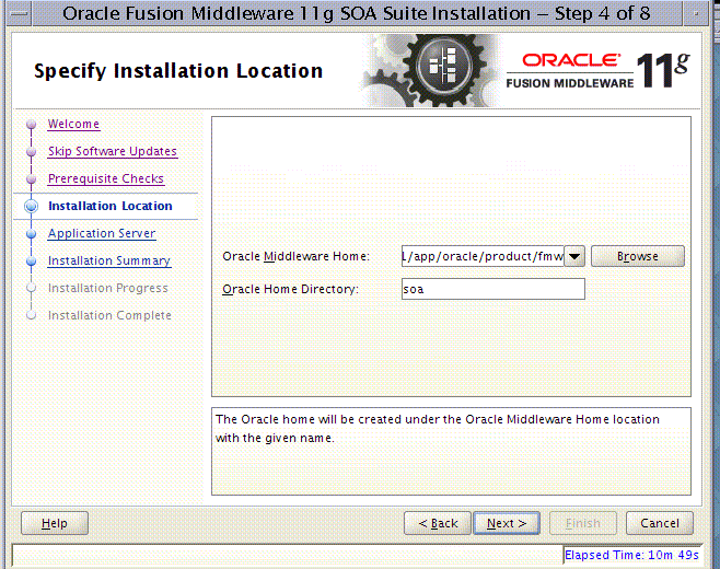

  7. In the Specify Installation Location screen, provide the installation location for Oracle SOA Suite. Select the previously installed Oracle Middleware Home from the drop-down list. For the Oracle Home directory, enter the SOA Suite directory name (soa).
    Figure 6-1 Specify Installation Location Screen in Installer Wizard
    Description of Figure 6-1 follows
    Description of "Figure 6-1 Specify Installation Location Screen in Installer Wizard"
    Click Next when you are done.
