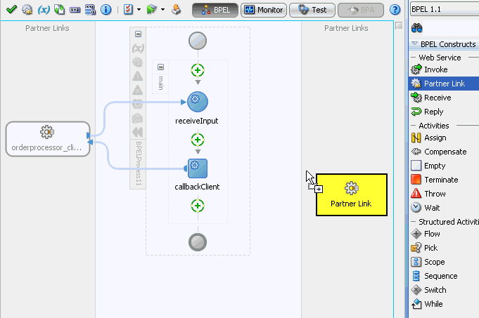

To create a partner link:
In the SOA Composite Editor, double-click the BPEL process service component.
Oracle BPEL Designer is displayed.
In the Component Palette, expand BPEL Constructs.
Drag a Partner Link into the appropriate Partner Links swimlane, as shown in Figure 4-10.
Figure 4-10 Partner Link Creation in Oracle BPEL Designer
The Create Partner Link dialog appears.
Complete the fields for this dialog, as described in Table 4-4.
