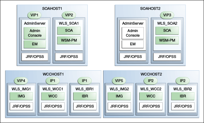

Configure the Administration Server and the managed servers to listen on different virtual IPs and physical IPs as illustrated in Figure 3-1. As shown in this figure, each VIP and IP is attached to the Oracle WebLogic server that uses it. VIP1 is failed manually to restart the Administration Server in SOAHOST2. VIP2 and VIP3 fail over from SOAHOST1 to SOAHOST2 and from SOAHOST2 to SOAHOST1, respectively, through the Oracle WebLogic Server migration feature. WLS_IMG1 and WLS_IMG2 also use server migration to fail over VIP4 and VIP5, respectively, from WCCHOST1 to WCCHOST2.
See the Oracle Fusion Middleware High Availability Guide for information on the WebLogic Server migration feature.
Physical IPs (non-virtual) are fixed to each node. IP1 is the physical IP of WCCHOST1 and is used as the listen address by the WLS_WCC1 server. IP2 is the physical IP of WCCHOST2 and is used as the listen address by the WLS_WCC2 server.
The virtual IP db-scan.mycompany.com is the database Oracle Single Client Access Name (SCAN) address for a GridLink data source.
Figure 3-1 IPs and VIPs Mapped to Administration Server and Managed Servers
Table 3-1 provides descriptions of the various virtual hosts.
Table 3-1 Virtual Hosts
Virtual IP | VIP Maps to... | Description |
VIP1 |
ADMINVHN is the virtual host name that is the listen address for the Administration Server and fails over with manual failover of the Administration Server. It is enabled on the node where the Administration Server process is running (SOAHOST1 by default). |
VIP2 |
SOAHOST1VHN1 is the virtual host name that maps to the listen address for WLS_SOA1 and fails over with server migration of this managed server. It is enabled on the node where WLS_SOA1 process is running (SOAHOST1 by default). |
VIP3 |
SOAHOST2VHN1 is the virtual host name that maps to the listen address for WLS_SOA2 and fails over with server migration of this managed server. It is enabled on the node where WLS_SOA2 process is running (SOAHOST2 by default). |
VIP4 |
WCCHOST1VHN1 is the virtual host name that maps to the listen address for WLS_IMG1 and fails over with server migration of this managed server. It is enabled on the node where WLS_IMG1 process is running (WCCHOST1 by default). |
VIP5 |
WCCHOST2VHN1 is the virtual host name that maps to the listen address for WLS_IMG2 and fails over with server migration of this managed server. It is enabled on the node where WLS_IMG2 process is running (WCCHOST2 by default). |
db-scan.mycompany.com |
db-scan.mycompany.com is the database Oracle Single Client Access Name (SCAN) address for a GridLink data source. |

The firewall ports depend on the definition of TCP/IP ports.
With Oracle Fusion Middleware, you can use different types of credential and policy stores in a WebLogic domain. Domains can use stores based on XML files or on different types of LDAP providers. When a domain uses an LDAP store, all policy and credential data is kept and maintained in a centralized store. However, when using XML policy stores, the changes made on managed servers are not propagated to the Administration Server unless they use the same domain home.
An Oracle WebCenter Content enterprise deployment topology uses different domain homes for the Administration Server and the managed servers, as described in Section 4.3, "Recommended Locations for the Different Directories." Derived from this, and for integrity and consistency purposes, Oracle requires the use of an LDAP server as policy and credential store in the context of an Oracle WebCenter Content enterprise deployment topology. To configure the Oracle WebCenter Content enterprise deployment topology with an LDAP as credential and policy store, follow the steps in Section 15.2, "Credential and Policy Store Configuration."
