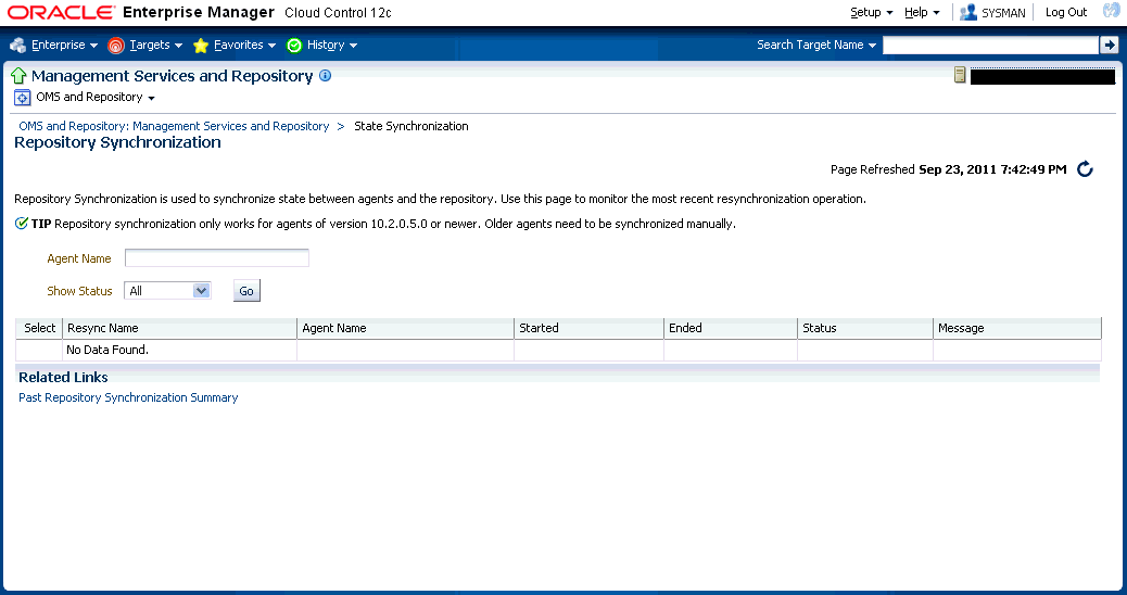

A repository resync feature allows you to automate the process of synchronizing the Enterprise Manager repository with the latest state available on the Management Agents.
To resynchronize the repository with the Management Agents, you use Enterprise Manager command-line utility (emctl) resync repos
command:
emctl resync repos -full -name "<descriptive name for the operation>"
You must run this command from the OMS Oracle Home AFTER restoring the Management Repository, but BEFORE starting the OMS. After submitting the command, start up all OMS instances and monitor the progress of repository resychronization from the Enterprise Manager console's Repository Resynchronization page, as shown in the following figure.
Figure 27-1 Repository Synchronization Page
Management Repository recovery is complete when the resynchronization jobs complete on all Management Agents.

When both OMS and Management Repository fail simultaneously, the recovery situation becomes more complex depending upon factors such as whether the OMS and Management Repository recovery has to be performed on the same or different host, or whether there are multiple OMS instances fronted by an SLB. In general, the order of recovery for this type of compound failure should be Management Repository first, followed by OMS instances following the steps outlined in the appropriate recovery scenarios discussed earlier. The following scenarios illustrate two OMS-Management Repository failures and the requisite recovery steps.
Management Repository and the primary OMS are installed on same host (host "A"). The Management Repository database is running in noarchivelog mode. Full cold backup is available. A recent OMS backup file exists ( emctl exportconfig oms). The Management Repository, OMS and the Management Agent crash.
Follow the Management Repository recovery procedure shown in Incomplete Recovery on the Same Host with the following exception:
Since the OMS OracleHome is not available and Management Repository resynchronization has to be initiated before starting an OMS against the restored Management Repository, submit "resync" via the following PL/SQL block. Log into the Management Repository as SYSMAN using SQLplus and run:
begin emd_maintenance.full_repository_resync('<resync name>'); end;
Follow the OMS recovery procedure shown in Section 27.5.4.1, "Single OMS, No Server Load Balancer (SLB), OMS Restored on the same Host."
Verify that the site is fully operational.
