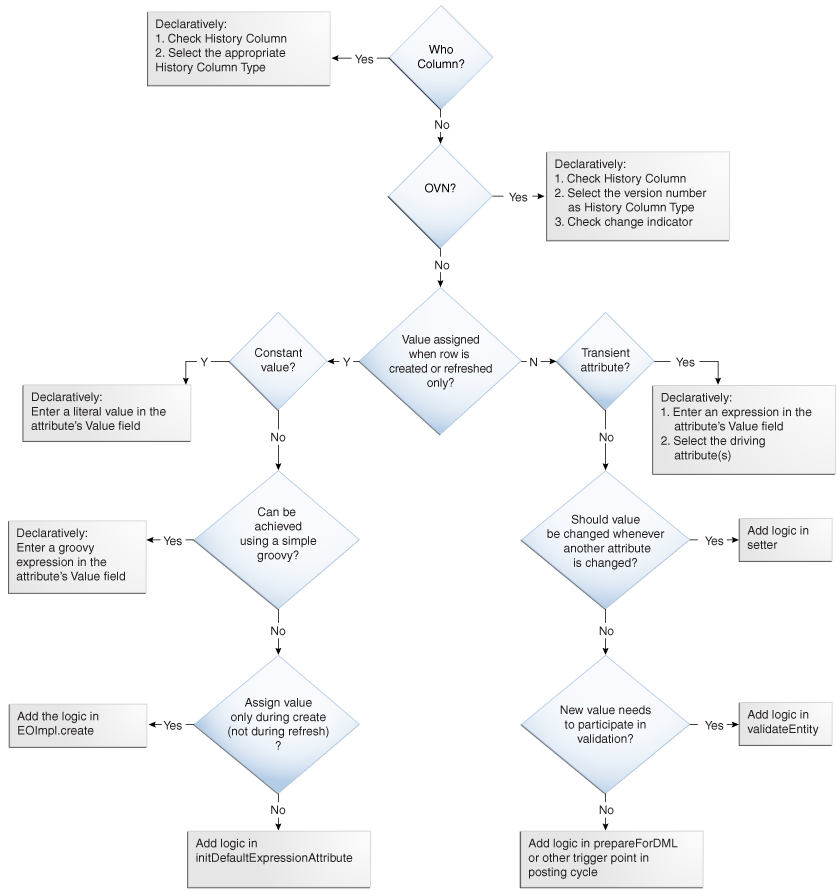

Figure 6-1, illustrates what you need to consider when determining whether to implement defaulting or derivation logic.
When implementing defaulting or derivation logic, you should also consider the following factors:

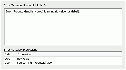

To get the attribute new value and label:
The above example uses the following two Groovy expressions:
newValue // This works because an attribute level validator has been created. source.hints.ProductId.label
and
source.structureDef.name+" of type "+sourceFullName

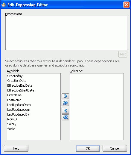

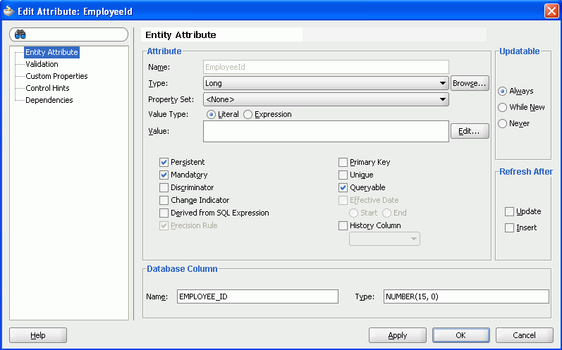

An expression for an attribute can be defined using either the Attribute Editor (see Figure 6-2) or the Expression Editor (see Figure 6-3).
If you want to define a string literal instead of a Groovy expression, select Literal as the Value Type and enter the value as "My Literal Value".
To access the Expression Editor, click the Edit button located next to the Value text box.
Recalculate Expression is used to determine whether the expression must be recalculated as changes are made during run-time. The Recalculate option is hidden for persistent attributes. This is because Persistent attribute values are always updateable by the user and therefore, the expression of the attribute should only act as a default expression so recalculation is not necessary. For non-persistent attributes, the user can choose to always recalculate, never recalculate, or decide if recalculation is needed based on the evaluation of the recalculate expression.
