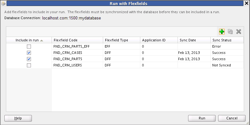

The Run with Flexfields and Debug with Flexfields dialogs enable you to test specific flexfields in an application, unbounded task, or JSF page.
The first time that you run either dialog from a JDeveloper instance, the table is empty. You can add and remove flexfields as desired and you can select which flexfields to include in a run.
When you add a flexfield, its status is set to Not Synced, meaning that you must synchronize it before you can include it in a run. When you synchronize a flexfield, its business components are generated using the definitions from the current database connection. In addition, all entity usages are generated and the synchronized artifacts are stored in a local directory. If a flexfield cannot be synchronized successfully, it shows a status of Error, as shown in Figure 26-1.
When you open the dialog, the Sync Status shows the state at the time the dialog was last closed, as long as the database connection has not changed. If the database connection has changed, then the status of every flexfield is changed to Not Synced. If you changed the flexfield after the value shown for Sync Date, then you should synchronize the flexfield again before using it in a run.
When you click Run or Debug, all flexfields that have been selected to include in the run and that have a status of Success will be included in the run.

From the Application Navigator, right click the project, unbounded task, JSF page, or file that you want to test (the target) and choose Run with Flexfields or choose Debug with Flexfields.
In the Run with Flexfields dialog (or the Debug with Flexfields dialog), click the Add icon to add flexfields to the table.
Optionally, select a flexfield and click the Remove icon to remove an unnecessary flexfield from the table.
If a flexfield that you want to test does not have a Sync Status of Success or the flexfield configuration was changed after the last time you synchronized it, select the flexfield and click the Synchronize icon to generate flexfield business components based on the current flexfield configuration in the database that is displayed for the Database Connection.
The Sync Status value for existing flexfield entries in the table reflects the status at the time the dialog was last closed. If you have made changes to a flexfield, you must synchronize it again even though it shows a Sync Status of Success.
Ensure that the Include in run check boxes for the flexfields that you want to test are selected.
Click Run (or click Debug if you are in the Debug with Flexfields dialog) to run the target in an Integrated WebLogic Server instance.

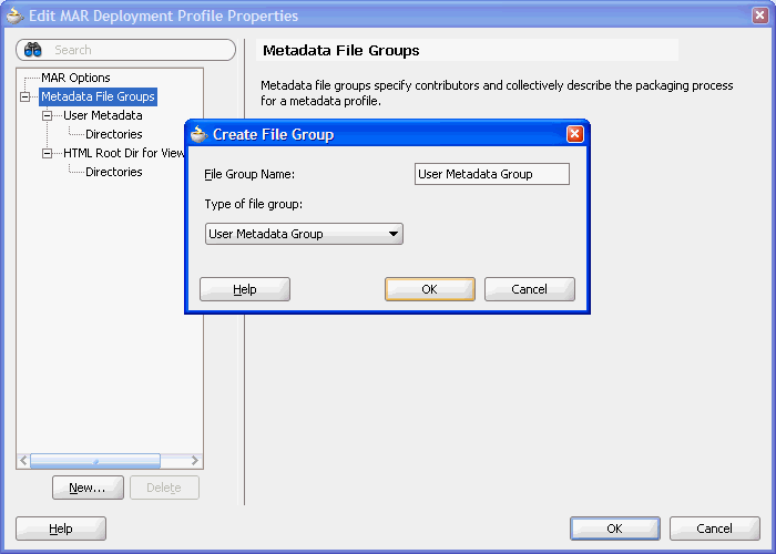

In the panel on the left-hand side of the Edit MAR Deployment Profile Properties dialog, under MAR Options, select Metadata File Groups and click New.
In the Create File Group dialog, enter a name for the user metadata group, as shown in Figure 26-2, and click OK.
In the User Metadata Group section, add a contributor, enter the path to your test components (a directory or archive), and click OK.

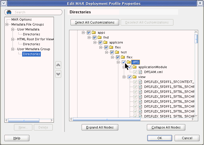

In the panel on the left-hand side of the Edit MAR Deployment Profile Properties dialog, under MAR Options, expand Metadata File Groups, expand the user metadata group that you just added, and select the Directories node.
In the Directories section, select the root package directory of the flexfield to be tested, as shown in Figure 26-3, and click OK.
Caution:
Ensure that you select the correct item. You must select the directory of the root package of the flexfield to be tested, such that only the objects that are below the level of that package come from the test directory. The root package should match the package that you previously registered with the business component's usage.
As soon as you select the package, Oracle JDeveloper automatically selects the parents all the way to the top of the folder hierarchy, but that does not mean everything under oracle
is registered with Oracle Metadata Services (MDS).
