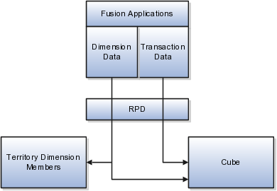

Dimension members are populated and synchronized in Oracle Business Intelligence Suite Enterprise Edition Plus either through the data warehouse, or without the use of data warehouse. You must repopulate dimension members when source data changes, such as changes in the product catalog and the addition of new customers.
When you do not use data warehouse, dimension and transaction data are populated directly from Fusion Applications into territory dimension members and the Oracle Essbase cube. The structure of the cube reflects the enabled dimensions in Territory Management and their members. The cube provides metrics information for defined territories.
This figure shows the population of the dimension members data and the Oracle Essbase cube using the Repository Project Design (RPD) view from Business Intelligence.

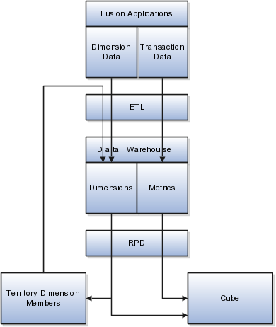

(On-Premise implementations only.) In the Data Warehouse option, the data warehouse Extract-Transform-Load (ETL) logic extracts transaction and dimension data from Oracle Fusion Applications into the data warehouse first. The data warehouse stores dimensions and metrics data. Metrics data is based on transaction information. Territory Management contains only a subset of the dimensions stored in data warehouse.
This figure shows the use of ETL to load data from Fusion Applications to the data warehouse, and RPD to provide data to the cube and to Territory Management. ETL also loads the settings for visible and invisible dimension members from Territory Management to the data warehouse.
Use ETL to load data to the data warehouse when:
There are changes in the dimension members sources (Fusion Application), so that the new structure of the dimensions is reflected in the data warehouse and consequently in Territory Management.
After changing visibility settings for dimension members.
Territory Management generates the cube based on the enabled dimensions and their members. In the case of the data warehouse option, Territory Management loads the cube with dimension members and metrics directly from the data warehouse. In the case of the non-data warehouse option, the application loads the cube from Fusion Applications. The cube provides metrics information for defined territories.
