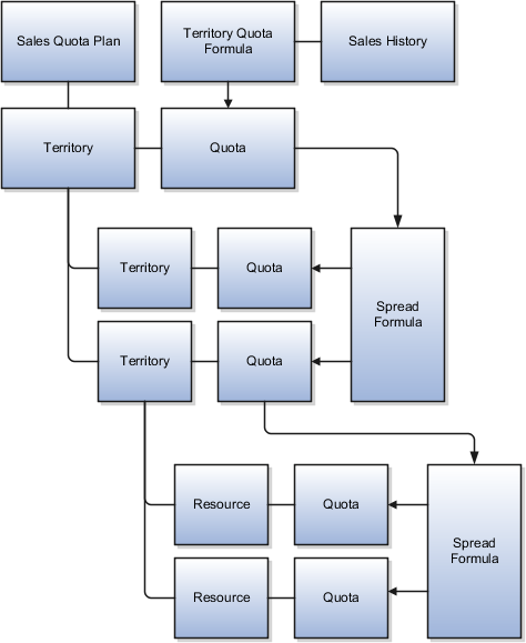

Quotas are a reflection of sales targets set for an individual in a sales organization. After a corporate goal is established, managers distribute quotas down through the sales territory hierarchy until all territories and their respective owners have quotas. Quota predictions based on historical sales information and metrics are provided as a comparison with quotas being set. Managers use one sales quota plan for the fiscal year.
In this figure, a sales quota plan contains several territories, each assigned a quota. Territory quota formulas compute predicted quotas based on historical sales information and metrics such as forecasts and market potential. The predicted quotas appear as default territory quota amounts. Managers assign territories to individual salespeople and sales managers. Applying spread formulas quickly allocates quotas among territories or resources.
Sales Quota Plan Components
Sales Quota Plan
A sales quota plan covers a period of one year. The administrator selects territories to include in the quota setting process, and can optionally add territory proposals to allow the setting of quotas for proposed territories.
For the sales quota plan options, the administrator selects an adjustment threshold, a territory quota formula, and a seasonality factor group to apply to all territories. Territory options override sales quota plan options. For example, the territory quota formulas and seasonality factor groups selected for individual territories override the formulas selected for all territories.

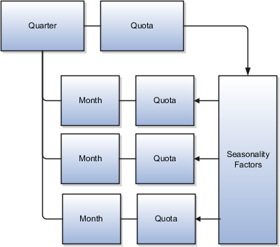

In this figure, the assigned quota gets distributed over each month through seasonality factors that raise or lower quota amounts according to seasonal fluctuations.
Seasonality Factors Applied to Quotas
