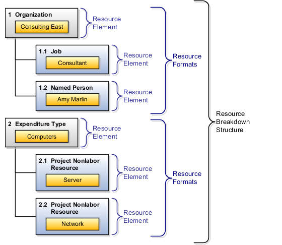

The resource breakdown structure consists of one or more hierarchies of resource elements. An element is a resource type, such as an organization or job, or a combination of resource type and specified resource, such as the job of consultant or a person named Amy Marlin.
The following diagram shows examples of hierarchical levels of resource elements:
You can add planning resources to any level of the resource format. You are not required to add resources to every level.
For example, assume that your resource breakdown structure has a resource format with three hierarchical levels. The top level is organization, the second level is expenditure category, and the third level is named person. You can add an organization resource to the first level, an expenditure category resource to the second level, and a named person to the third level. Alternatively, you may add a named person to the third level only, and not add planning resources to the first two levels.

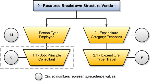

Oracle Fusion Projects uses the following rules to associate cost amounts with resources:
Select the lowest level in the resource breakdown structure to which a transaction can map.
If there is only one level to which the transaction maps, the cost amounts are mapped to that level.
If the transaction maps to more than one level, Oracle Fusion Projects sums the precedence numbers for all resource types in the branch, and gives precedence to the resource element in the branch with the lowest sum.
If more than one branch has the lowest precedence number at the lower level, the application uses the precedence number of the next level up.
If the sum of precedence numbers is the same for more than one branch, precedence is given to the branch with the lowest number at the lowest level.
If one branch contains a user-defined resource type, precedence is given to the branch that does not contain a user-defined resource type.
Note
Oracle Fusion Projects gives more precedence to a lower precedence number. For example, a resource element with a precedence number of 1 is given precedence over a resource element with a precedence number of 10.

This example illustrates that precedence is given to the branch with the lowest number at the lowest level if the sum of precedence numbers is the same for more than one branch.
In this example, a time card transaction for a principle consultant who incurs travel expenses maps to two branches.
The first branch consists of two levels (1-Person Type: Employee and 1.1-Job: Principle Consultant). The highest level has a precedence number of 14, and the lowest level has a precedence number of 6, for a sum of 20 for the branch
The second branch also consists of two levels (2-Expenditure Category: Expenses and 2.1-Expenditure Type: Travel). The highest level has a precedence number of 11, and the lowest level has a precedence number of 9, for a sum of 20 for the branch.
The transaction cost amount is mapped to the Job: Principle Consultant resource element because it has the lowest number (6) at the lowest level.
