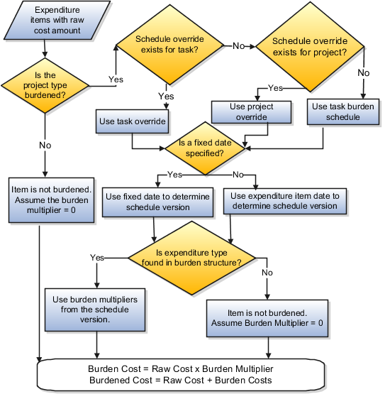

The following is a diagram of the burden cost calculation process and its explanation:
Expenditure items with a raw cost amount are selected for processing.
The process determines if the related project type of the expenditure item is defined for burdening.
If the project type is enabled for burdening, then the process determines the burden schedule to be used.
If the project type is not enabled for burdening, then the expenditure item is not burdened. The process assumes the burden multiplier is zero; therefore, burden cost is zero and thus burdened cost equals raw cost.
To determine which burden multiplier to use, the process determines if there is a burden schedule override for the expenditure.
If a burden schedule override exists, then the process uses the task burden schedule override on the associated task.
If no task burden schedule override exists on the associated task, then the process uses the project burden schedule override on the associated project.
If there are no burden schedule overrides, the process determines the burden schedule to use for burden cost calculations in the following order:
Burden schedule assigned at the task level
Burden schedule assigned at the project level
The process checks if a fixed date is specified for burdening. If yes, it uses the fixed date to determine the schedule version.
If fixed date is not specified, then the process uses the expenditure item to determine the burden schedule version.
After a schedule version is determined, the process verifies that the expenditure type of the expenditure item is found in any of the cost bases of the selected burden schedule version.
If an expenditure type is excluded from all cost bases in the burden structure, then the expenditure items that use that expenditure type are not burdened (burden cost equals zero, thus burdened cost equals raw cost).
The application calculates burden cost and burdened cost amounts according to the following calculation formulas:
Burden cost equals raw cost multiplied by a burden multiplier.
Burdened cost equals the sum of raw cost and burden costs.

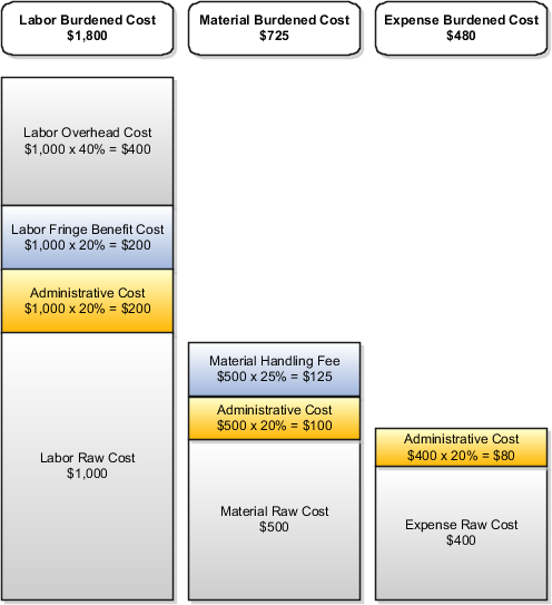

The following diagram shows the expenditure types and burden cost codes that are assigned to the Labor, Material, and Expense burden cost bases.
The following table shows the multipliers that are used to calculate burden costs for raw costs in the Labor, Material, and Expense cost bases. This is an additive burden structure that applies each burden cost code to the raw costs in the appropriate cost base.
Note
Multipliers are defined on the burden schedule.
Burden Cost Base |
Raw Cost Amount (USD) |
Administrative Cost Code Multiplier |
Labor Fringe Benefit Cost Code Multiplier |
Labor Overhead Cost Code Multiplier |
Material Handling Cost Code Multiplier |
Labor |
1,000 |
.20 |
.20 |
.40 |
Material |
500 |
.20 |
.25 |
Expense |
400 |
.20 |
The following diagram shows the resulting burdened costs for labor, material, and expenses.

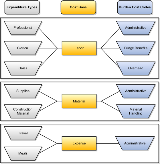

You define the project cost buildup using a burden structure. A burden structure determines how you group expenditure types into burden cost bases and establishes the method of applying burden costs to raw costs. Before creating burden structures you must define expenditure types, cost bases, and burden cost codes, which are the main components of a burden structure.
The diagram illustrates a burden structure with the following cost bases.
Labor
Includes the expenditure types Professional, Clerical, and Sales.
Is assigned the burden cost codes Administrative, Fringe Benefits, Overhead.
Material
Includes the expenditure types Supplies and Construction Material.
Is assigned the burden cost codes Administrative and Material Handling.
Expense
Includes the expenditure types Travel and Meals.
Is assigned the burden cost code Administrative.

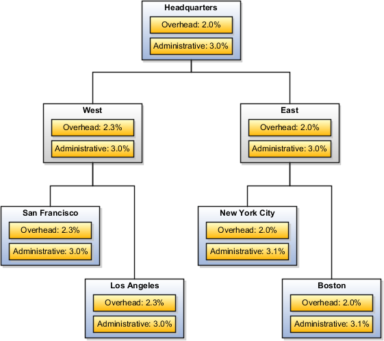

The organization hierarchy is used to cascade rates down to lower level organizations where multipliers are not explicitly defined. If Oracle Fusion Projects finds a level in the hierarchy that does not have a multiplier defined, the application uses the multipliers of the parent organization. Therefore, an organization multiplier schedule hierarchy is used to identify the exceptions. You define the multipliers for an organization only if you want to override the multipliers of the parent organization.
The following diagram shows an example of multipliers that are used by organizations. The parent organization, Headquarters, has two defined multipliers: Overhead with a multiplier of 2.0, and Administrative with a multiplier of 3.0.
When the application processes transactions for the East organization, no multipliers are found. Therefore, the application uses the multipliers from the parent organization, Headquarters.
The Boston and New York City organizations are assigned an Administrative multiplier of 3.1, and no Overhead multiplier. Therefore, the application uses the Administrative multiplier of 3.1, and the Overhead multiplier from the Headquarters organization, when processing transactions for the Boston and New York City organizations.
The West organization is assigned an Overhead multiplier of 2.3, and no Administrative multiplier. Therefore, the application uses the Overhead multiplier of 2.3, and the Administrative multiplier from the Headquarters organization, when processing transactions for the West organization.
No multipliers are assigned to the San Francisco and Los Angeles organizations. Therefore, the application uses the Overhead multiplier from the West organization, and the Administrative multiplier from the Headquarters organization, when processing transactions for the San Francisco and Los Angeles organizations.
