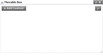

In page edit mode, a Box is typically rendered as rectangle comprised of dashed lines, an Add Content button, and Add a Tab Set or a Tab, Add Box, Edit, and Delete icons (Figure 19-2).
Figure 19-2 Box Component
Box layout component
Description of "Figure 19-2 Box Component"
Not all Box controls appear every time. What you see depends on your permissions, whether the Box is the top-most Box (which cannot be deleted, thus no Delete icon), whether the Box is stretched (in which case you cannot add other Boxes to it, thus no controls for doing so), and whether Box properties are set to show or omit certain controls (for more information, see Table 19-1, "Box Component Display Options").
You can place content within a Box, and you can place one or more Boxes within a Box (unless the Box is configured to stretch its content, that is, the Box property Layout equals stretch). You can configure Box properties to display content horizontally, vertically, or stretched. You can specify the display of a scrollbar or set the Box to devote all its area to a single component (stretched). You can use Box controls to add Boxes above, below, or to either side of a given Box and to add a tab or a tab set within the Box.

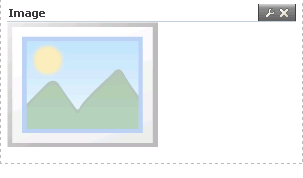

Use the Image component to add a picture, a logo, a linked image, and the like to a page (Figure 19-6).
Figure 19-6 Image Component
Image layout component
Description of "Figure 19-6 Image Component"
Use any web-compatible image from any accessible location. Do not use images from an external server that requires authentication.

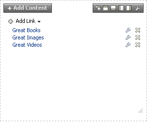

Figure 19-7 Links Component
Links layout component
Description of "Figure 19-7 Links Component"
The links component is associated with the page or template on which it is placed. When you put a links component on a page and add some links, those links are associated with the page. That is, the lifecycle of the links component respects the lifecycle of the page or template on which it is placed. For example:
  • When a page containing links is copied, all the links are also copied, and the page copy has its own set of links. Modifying links on the original page does not affect the page copy. The same is true for links on page templates.
  • When a page is deleted, all links associated with the page are also deleted. The same is true for links on page templates.
  • If a space template contains pages with links, creating a new space based on the template effectively creates a clone of the template. Consequently, the new space has links that are separate from the ones in the template.
  • When a space is exported or imported, any links associated with space pages are also exported or imported.

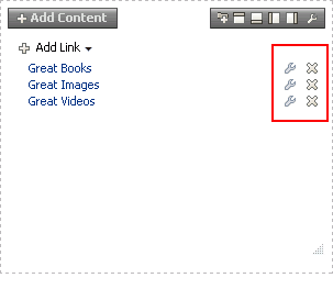

The Links component's Add, Edit, and Delete Link UI is available in both page view and page edit modes to users with Edit Page permission on the page. Users without Edit Page permission see only the added navigation links. Changes in both edit and view modes are visible to all users who can view the page. That is, the addition of links falls outside the constraints of user customization, where changes made in page view mode are visible only to the user who made them.
A control is available for specifying that a link target is opened within the context of the current page template or in place of the page on which it was invoked. There are also controls on each link for configuring a given link's properties and deleting the link (Figure 19-8).
Figure 19-8 Controls on Individual Links
Controls on individual links
Description of "Figure 19-8 Controls on Individual Links"
The Links component's properties provide opportunities for controlling the behavior and look and feel of a Links component instance. For more information, see Section 19.9.3, "Setting Links Component Properties."

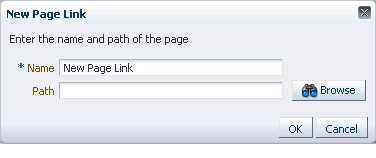

    To add a Page Link:
    1. Select Page Link to open the New Page Link dialog (Figure 19-9).
      Figure 19-9 New Page Link Dialog
      Description of "Figure 19-9 New Page Link Dialog"
    2. In the Name field, enter a display name for the link.

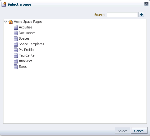

    3. For Path, click Browse to open the Select a Page dialog (Figure 19-10).
      Figure 19-10 Select a Page Dialog
      Select a page dialog
      Description of "Figure 19-10 Select a Page Dialog"
    4. Select a page from the given options, or click Search to locate a page on the available list of pages.
      Tip:
      In the Home space, you can select from pages that are available to you in your view of the Home space. In other spaces, you can select from pages that are available within the scope of the current space.
    5. Click Select.
    6. Click OK.

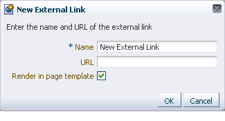

    To add an External Link:
    1. Select External Link to open the New External Link dialog (Figure 19-11).
      Figure 19-11 New External Link Dialog
      Description of "Figure 19-11 New External Link Dialog"
    3. In the URL field, enter the URL to the link target, for example:
      http://www.mywebdestination.com
    4. Select Render in page template to present the link target content within the context of the current page template.
      Deselect this check box to redirect the current page to the link target.
    5. Click OK.

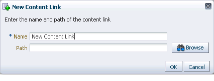

    To add a Content Link:
    1. Select Content Link to open the New Content Link dialog (Figure 19-12).
      Figure 19-12 New Content Link Dialog
      Description of "Figure 19-12 New Content Link Dialog"
    3. For Path, click Browse to open the Select Document dialog.
      If necessary, you can use the Filter feature to locate it. For a more pointed search, click Advanced. For more information, see Section 19.9.2.2, "Configuring an Advanced Search for Content Links."
    4. Click Select.
    5. Click OK.

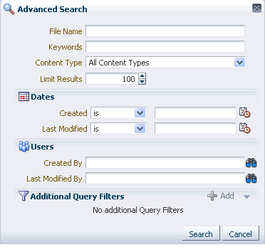

19.9.2.2 Configuring an Advanced Search for Content Links
The Links component's Advanced Search feature provides controls for specifying additional search criteria and filters for Content Links searches (Figure 19-13).
Figure 19-13 Advanced Search Dialog
Advanced Search dialog
Description of "Figure 19-13 Advanced Search Dialog"
This search is very similar to an advanced document search. For more information, see Section 43.31.2, "Running an Advanced Document Search."

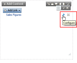

19.9.2.3 Configuring a Link in the Links Component
Users with Edit Page permission on the page can access a configure control on a given link to revise the link's name and target. If you can see the Configure icon to the right of a link, you are authorized to configure links (Figure 19-14).
Figure 19-14 Configure Icon on a Link
Configure icon on a link
Description of "Figure 19-14 Configure Icon on a Link"

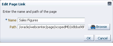

To configure a link in the Links component:
  1. Go to the Links component instance of interest.
  2. Click the Configure icon to open the Edit type Link dialog (Figure 19-15).
    Figure 19-15 Edit Page Link Dialog
    Edit Page Link dialog
    Description of "Figure 19-15 Edit Page Link Dialog"
  3. Revise the values as required.
    Different link types present different fields and require different values.
    For information about the values required by Edit type Link fields, see Section 19.9.2.1, "Adding Navigation Links Using the Links Component."
  4. Click OK.

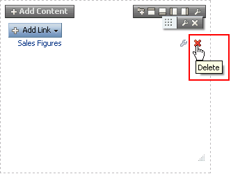

19.9.2.5 Deleting a Link from the Links Component
Authorized users can access a delete control on a given link to remove the link from the Links component. If you can see the Delete icon to the right of each link, you are authorized to delete links (Figure 19-16).
Figure 19-16 Delete Icon on a Link
Delete icon on a link
Description of "Figure 19-16 Delete Icon on a Link"
To delete a link from the Links component:
  2. Click the Delete icon next to the link of interest.
  3. Click the Delete button in the confirmation dialog.

19.10 Working with the Movable Box Component
This section provides an overview of the Movable Box component. It includes the following subsections:
19.10.1 What You Should Know About the Movable Box Component
To add a Movable Box component to a page, see Section 19.2, "Adding a Web Development Component to a Page."
A Movable Box (Figure 19-17) is a container wrapped around a Box that not only enables the placement of content on a page, but also provides a means of moving all of that content at once in both page edit mode and page view mode.
Figure 19-17 Movable Box Component
Movable Box layout component
Description of "Figure 19-17 Movable Box Component"
In page edit mode or page view mode, you can click on a Movable Box header and drag it and all of its content to a new position on a page. Movable Boxes can also be resized.
Tip:
Avoid adding a portlet to a Movable Box component. Doing so creates an unnecessary and potentially error-prone redundancy.
19.10.2 Setting Movable Box Component Properties
See Also:
For information about accessing and setting properties for any component on a page, see Section 18.6.2, "Setting Properties on a Component."
The Display Options associated with Movable Boxes provide a means of hiding or showing the Movable Box header, providing header text, adding a tooltip to the Movable Box that users see when they roll their mouse pointers over the header, and other like controls.
Movable Box Display Options are common to many other types of components and are listed in Table 18-1, "Display Options Properties".
Movable Box Display Options are presented on two subtabs: Basic and Advanced (Figure 19-18).
Figure 19-18 Movable Box Component Display Options
Movable Box display options
Description of "Figure 19-18 Movable Box Component Display Options"
By default, each Movable Box encloses a Box component. For information about Box component properties, see Section 19.4.2, "Setting Box Component Properties."

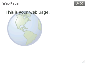

The Web Page component provides a means of opening a view onto another web page within the context of a Spaces application page (Figure 19-21).
Figure 19-21 Web Page Component
Web Page layout component
Description of "Figure 19-21 Web Page Component"
The content exposed through a Web Page component retains all of the controls associated with the exposed web page. These controls retain their functionality, enabling you to, for example, control the volume of a video, edit a wiki, or post an entry to a blog, depending on the type of content you expose.
You can use internal and external link targets for a Web Page. For an internal target, you can use a relative directory path.
