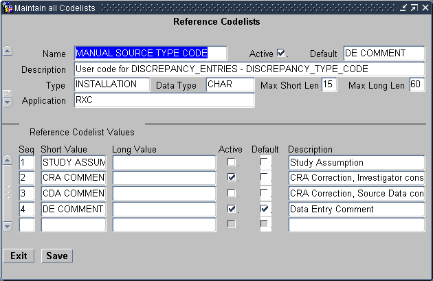

When a user adds a manual discrepancy to a CRF, RDC Onsite displays the Add Discrepancy dialog box. The user must select a reason for the discrepancy from the list in the Reason field. Optionally, the user can enter additional comments about the discrepancy.
To define the list of reasons for a manual discrepancy, you modify the MANUAL SOURCE TYPE CODE reference codelist in Oracle Clinical. (See Figure 4-1.) For each reason, you enter values into the Short Value field and the Description field.
RDC Onsite displays the text you enter in the Description field as the list of reasons that the user can select from when adding a manual discrepancy. Oracle Clinical stores the short value in the database.
The first time the user adds a manual discrepancy during a login session, RDC Onsite automatically displays the default reason in the Reason field. The user can select a different reason from the drop-down list. For subsequent manual discrepancies added by the user, RDC Onsite displays the last reason the user selected. The user can always select a different reason.
Figure 4-1 Defining the Reasons for a Manual Discrepancy

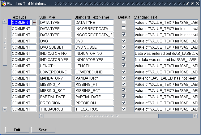

When a univariate discrepancy is raised, RDC Onsite automatically determines which reason to use based on the type of univariate discrepancy. Examples of reasons for univariate discrepancies are DATA TYPE, LENGTH, and MANDATORY.
To define the reasons for univariate discrepancies:
Open Oracle Clinical.
Navigate to Admin, Discrepancy Mgmt Admin, and then select Standard Text Maintenance. See Figure 4-2.
Figure 4-2 Defining the Reasons for Univariate Discrepancies
You use the fields in the Standard Text Maintenance form to describe each type of univariate discrepancy as follows:
Text Type — Select COMMENT to indicate that this row defines one description for a univariate discrepancy.
Sub Type — Select from the list of valid types of univariate discrepancies.
Standard Text Name — Ordinarily, you specify a name to match the Sub Type. However, if you want to specify more than one reason for a discrepancy type, use this field to specify a unique identifier.
Default — If you specify more than one reason for a certain type of discrepancy, select which reason is the default value. RDC Onsite uses the default value the first time a discrepancy of that type is raised. The user can always select one of the alternative reasons provided.
Standard Text — Specify the description that you want RDC Onsite to display for the discrepancy type raised. Note that you can use variables to include the data value of the discrepant response as well as the definitional components of the question.
See the Oracle Clinical Administrator's Guide for details on creating default standard text depending on the type of univariate discrepancy.

Only RDC Onsite uses the DISCREPANCY NO OTHER UPDATE installation codelist.
You can use the DISCREPANCY NO OTHER UPDATE codelist to specify which user roles do not have access to and cannot update discrepancies that appear to them with a status of OTHER.
By default, the DISCREPANCY NO OTHER UPDATE codelist has no values. All users can update discrepancies with a status of OTHER. To prevent users from updating OTHER discrepancies, you add one or more user roles to the codelist.
To prevent users with a particular role from updating OTHER discrepancies:
Open the DISCREPANCY NO OTHER UPDATE codelist.
Enter the role name in the Short Value field. The value you enter must be exactly the same as one of the long values in the USER GROUP ROLES reference codelist. For example, CRA, INV, or SITE.
Caution:
The system does not check the validity of your entries. You must be careful to specify only valid user roles. If the values do not match exactly, users with the role will still be able to update OTHER discrepancies.Select the Active check box. An active entry indicates the user role cannot update OTHER discrepancies.
Save your changes.
The Seq, Long Value, Default, and Description fields are not used by RDC Onsite.
You can grant this privilege to any number of roles.
To allow the update of OTHER discrepancies for a role that you added to the DISCREPANCY NO OTHER UPDATE codelist, you can either:
Delete the record by using the command on the Data menu.
Make the value inactive by clearing its Active check box.
