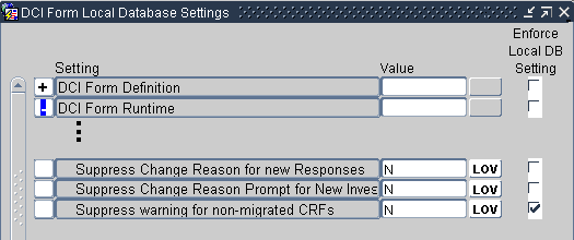

The DCI Form Runtime settings let you customize the RDC Onsite application, including the following options:
In Oracle Clinical, you can configure the DCI Form Runtime settings at the database level or at the study level.
At the database level, the DCI Form Runtime settings define the default values when a new study is created. For each setting, you can choose to enforce the default value across all studies in the database or allow modification at the study level. You define the default values in the DCI Form Local Database Settings form.
To define the DCI Form Runtime settings at the database level:
Open Oracle Clinical.
Navigate to Admin and select DCI Form Local Database Settings.
Expand the DCI Form Runtime node. See Figure 5-1.
Figure 5-1 DCI Form Runtime Settings for RDC Onsite
Change the value of the settings you want. The sections that follow provide provide more information about each setting.
Select the Enforce Local DB Setting check box to always use this value as the default value.
If not selected, a user who has privileges to the DCI Form Study Database Settings form at the study level can override the default values.
Note that the Enforce Local DB Setting check box is always selected for the Suppress warning for non-migrated CRFs setting because you cannot change its value at the study level.
Save your changes.

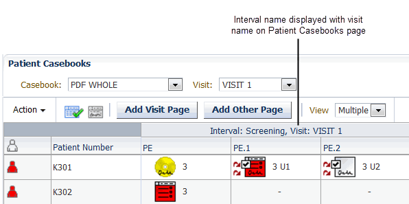

The DCI Forms Definition Enabled? setting, which is also in the Clinical Study States form, controls the ability to define DCI Forms for the selected study.Use the Display Visit Owning Interval on MPC Page? setting to customize the spreadsheet heading on the RDC Onsite Casebooks page.
If set to Y, the spreadsheet heading on the Casebooks page displays the name of the interval — phase, period, or subperiod — along with the name of the current visit.
If set to N, the spreadsheet heading on the Casebooks page displays only the name of the current visit. The default value is N.

You can use the DCI Form Runtime settings to suppress the:
Change reason prompt for new responses
Change reason prompt for new investigator comments
Warning for non-migrated CRFs

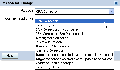

By default, RDC Onsite requires users to specify a change reason whenever they update any data in a CRF previously saved complete. Updating data includes adding new responses, modifying existing responses, and deleting responses.
If the Suppress Change Reason for New Responses setting is Y, RDC Onsite does not prompt users for a change reason when they add a new response (that is, a response entered for the first time) to a CRF previously saved complete. RDC Onsite automatically saves the change reason as RESP_ADDED.
Note that RDC Onsite considers a response to be new only if:
The response value is null.
The response has no audit history.
The existence of an investigator comment or any investigator comment history does not factor into the audit history of a response. If a response is null and has always been null but has an investigator comment, the response is still considered new (that is, being entered for the first time).

You customize the list of change reasons presented in RDC Onsite by using the following installation reference codelists:
DATA CHANGE REASON TYPE CODE — Use this codelist to customize the list of acceptable change reasons for updates made to response or data fields, that is any field except a header field.
RDCI CHANGE REASON TYPE — Use this codelist to customize the list of acceptable change reasons for updates made to header fields such as Visit date, Visit time, CRF comment, blank flag, lab, or qualifying value.
To access the codelists for customizing the change reasons:
Navigate to Admin, Reference Codelists, and then select Installation Codelists.
Query for the codelist you want to modify.
Table 5-3 lists the initial values in the Data Change Reason Type Code codelist.
Table 5-3 Initial Values for the DATA CHANGE REASON TYPE CODE Codelist
| Short Value | Description |
DATA ENTRY ERR |
Data Entry Error |
BATCH |
Batch |
CRA CORR |
CRA Correction |
CRA CORR-INV |
CRA Correction, Inv consulted |
CRA CORR-SRC |
CRA Correction, Src Data consulted |
INV CORR |
Investigator Correction |
STUDY ASSUMP |
Study Assumption |
THES CLARIF |
Thesaurus Clarification |
ANALYSIS CORR |
Analysis Correction |
REMOVED |
Received DCI Removed |
COND VIOLATION |
Target responses deleted due to mismatch with conditional response |
VAL STATUS CHG |
Validation Status changed |
COND RESP UPDT |
Target responses deleted due to update to conditional response |
DATA ENTRY MODE |
Data entry mode |
Oracle Clinical and RDC Onsite reserve the following change reasons for system use:
BATCH
BROWSE
KEY CHANGE
PASS1
PASS2
RECONCILIATION
REMOVED
TRANSLATION
UPDATE
You cannot specify these reserved change reasons in either the DATA CHANGE REASON TYPE CODE codelist or the RDCI CHANGE REASON TYPE codelist.
In both the DATA CHANGE REASON TYPE CODE codelist and the RDCI CHANGE REASON TYPE codelist, select a Default check box to mark one of the change reasons as the default. See Figure 5-2.
In a given RDC Onsite user session, the first Reason for Change dialog box pre-selects the default change reason, allowing the user to select any other change reason from the list. If the user selects another change reason, subsequent displays of the Reason for Change dialog box pre-select that change reason.
RDC Onsite data entry uses the same change reason reference codelists that are referenced by Oracle Clinical data entry. To mark any change reason that should not be used in RDC Onsite, specify NOTRDC in the Long Value field for the appropriate change reason entry. Figure 5-2.
Note that the NOTRDC setting applies only to RDC Onsite. Specifying NOTRDC for a change reason does not affect the use of the change reason in Oracle Clinical data entry or in pre-4.5.3 versions of RDC data entry.

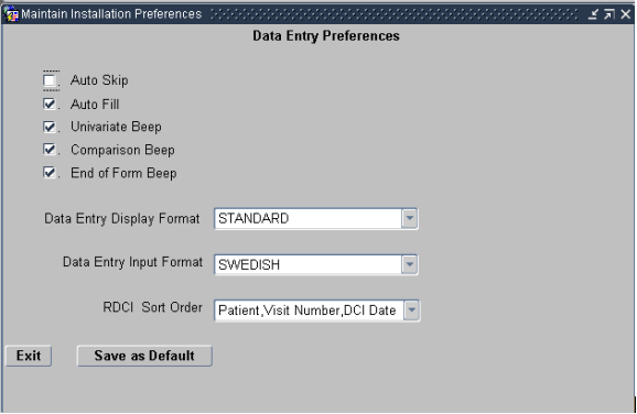

You use the Data Entry Preferences form in Oracle Clinical to specify the display and input formats for date fields in RDC Onsite. Table 5-4 describes the date preferences that you can set.
The Data Entry Preferences form is available at the database level and at the user level. The database-level preferences for date formats are in effect unless you override that specification at the user level. In addition, if the Preferences link is enabled in RDC Onsite, the user can override the values for these options.
Although user-level settings generally override database-level settings, when a data type discrepancy is raised for a date field, the resulting warning message displays the discrepant date in the format specified at the database level. Therefore, Oracle recommends that you always specify STANDARD (DD-MON-YYYY) as the Data Entry Display Format at the database level.The other possible values can be misconstrued: US (MM-DD-YYYY), European (DD-MM-YYYY), and Swedish (YYYY-MM-DD).
Oracle Clinical uses all the preference settings in the Data Entry Preferences form. However, RDC Onsite uses only the Data Entry Display Format and the Data Entry Input Format preference settings.Table 5-4 Data Entry Preferences
| Preference | Description | Format |
Data Entry Display Format |
For DCI and DCM dates and data entry format, the Data Entry Display Format setting determines the format to use for displaying dates. The data entry display format must either be Standard or must match the input format. You can suppress the day and/or month portion of the data depending on how the question is defined. The display is controlled by the Date Time Format of the DCM question on which it is based. The valid Date Time Formats for a date field are as follows:
US (mm-dd-yyyy); default EUROPEAN (dd-mm-yyyy) SWEDISH (yyyy-mm-dd) STANDARD (dd-mon-yyyy) |
Data Entry Input Format |
For DCI and DCM dates and data entry fields of type date, the Data Entry Input Format setting determines how date formats are applied to interpreting data that is input to the field. Must be the same as the Data Entry Display Format setting, unless the display format is set to STANDARD. The standard format is always accepted. |
US (mm-dd-yyyy); default EUROPEAN (dd-mm-yyyy) SWEDISH (yyyy-mm-dd) |
To modify date preferences at the local database level:
Navigate to Admin, DE Admin, and then select DE User Prefs.
Set your preferences for the Data Entry Display Format and the Data Entry Input Format.
Click Save as Default to save your changes.
To modify the date preferences for an individual user:
Navigate to Admin, Users and Roles, and then select Oracle Accounts.
Press F7 to open the query screen.
Enter name of user or enter an account name.
Press F8 to display all users that match your specified search criteria. Navigate to the applicable user.
Open the Special menu, and then select DE Prefs.
Users can also override the display and entry format by clicking the Preferences link in RDC Onsite. This method permanently changes the preference for the user and has the same effect as setting it through Oracle Accounts.
You can customize the RDC Onsite application to not display the Preferences link. See Section 3.3.2, "Hiding the Preferences Links" for more information.
