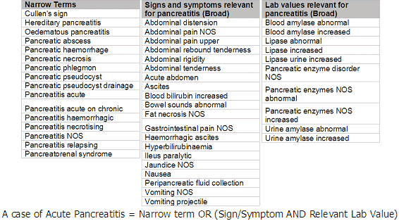

Standardized MedDRA Queries (SMQs) are designed to aid in the identification and retrieval of case safety reports in clinical studies. The MedDRA Maintenance and Support Services Organization (MSSO) defines SMQs as follows:
SMQs are groupings of terms from one or more MedDRA System Organ Classes (SOCs) that relate to a defined medical condition or area of interest. They are intended to aid in case identification. The included terms may relate to signs, symptoms, diagnoses, syndromes, physical findings, laboratory and other physiologic test data, etc., related to the medical condition or area of interest. Lowest Level Terms (LLTs) that are not subordinate to an included Preferred Term (PT) are excluded.
See Figure 6-1, "Acute Pancreatitis SMQ Terms and Algorithm" for an example of a MedDRA SMQ.

  • Algorithm. Algorithms within SMQs are used to further define combinations of specific terms based on rules defined in an algorithm that can be processed programmatically during a search operation.
    To support SMQ algorithms, define an Informative Note of type Algorithm for SMQ terms with algorithms; see "Defining Informative Notes for SMQ Algorithms".
    MSSO provides predefined categories of terms called A…F. You must load these categories with SMQ filter dictionary terms and store them in the Status column of the table TMS_DICT_RELATIONS. Some SMQ algorithms use these categories.

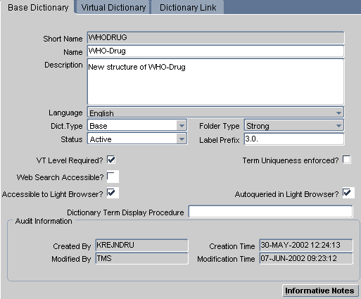

See "Defining a Dictionary" for detailed instructions on how to define a dictionary. Select Filter as the Dict Type and observe the following rules for filter dictionaries:
  • Language. Filter dictionaries and their base dictionaries must have the same language attribute setting.
  • VT Level Required. Uncheck. Filter dictionaries cannot have a VT level.
  • Folder Type. Filter dictionaries must be designated as Strong type.
  • Dictionary Link. A filter dictionary must have one and only one "Filter Dictionary Of" dictionary link to a base dictionary. This dictionary link defines the fact that the filter dictionary will contain only terms defined in the base dictionary.
    A base dictionary can have one and only one "has Filter Dictionary" link to a filter dictionary.

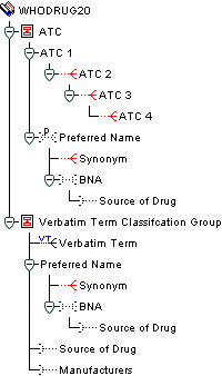

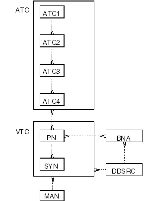

TMS provides flexibility in designing dictionaries, including those supplied by vendors. You can design the dictionary structure, ranking levels hierarchically and/or creating levels at the same rank. You can define the cardinality and optionality of level relations, and specify a Primary Link or Primary Path Link between levels.
Basic strategies for organizing dictionary structure include:
  • Ranking levels in a vertical hierarchy so that terms become more general and fewer in each higher level of the hierarchy, effectively organizing lower-level terms into categories.
  • Adding levels horizontally, at the same rank, to provide supplementary information about terms, such as preferred names or indications.
  • Assigning levels to group levels to promote efficiency and enforce Primary Links to more than one level (see "Requiring a Primary Link to a Group Level").
  • Defining the classification level as a group level that includes both the conventional classification level and a synonym level with a many-to-one relation to the classification level. In this case, TMS searches in both sublevels for a match to a verbatim term. If it finds a match in the synonym level, it creates the VTA to link directly to the related conventional classification level term. Because of this behavior, using group levels as classification levels greatly increases the likelihood that a match will be found without increasing the number of terms in the conventional classification level.

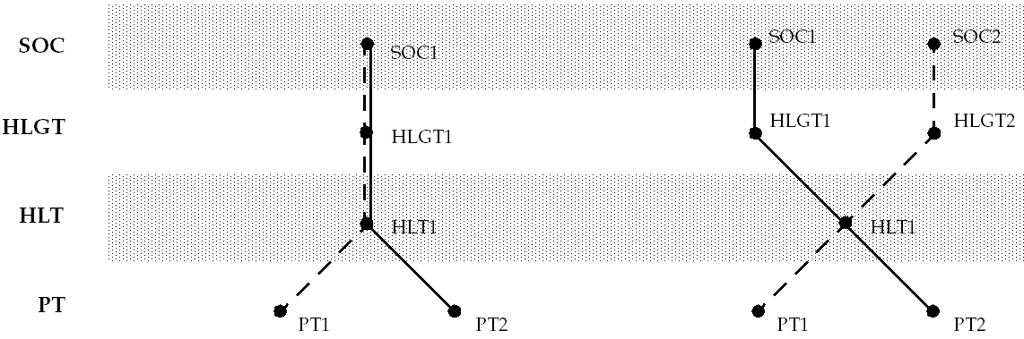

If you want to create strong dictionary relations in TMS, so that you can link terms in one level to terms in another, you must define relations between the levels in the dictionary structure.
During Activation, TMS checks all terms and relations against the relations defined for their dictionary levels. Terms and relations whose definitions conflict with the defined level relations cannot be activated. For example, if you have defined relations to more than one term in a level with a Single cardinality relation, the Activation job activates the first relation it processes and rejects the rest.
You must define the following attributes for relations between levels within a strong dictionary: Mandatory Relations and Cardinality. For relations with Many cardinality defined you can also define a Primary Link or, if the dictionary includes a group level, a primary path.
The relations you define between levels create the derivation path for verbatim terms associated with the dictionary. A valid derivation path enables TMS to derive one and only one term from each level above the verbatim term level, and send the derived terms to an external system such as Oracle Clinical (see "Derivation Path"). If Single cardinality is defined from the lower to the higher level, no Primary Link is required because a term in the lower level can be related to only one term in the higher level, and TMS can derive that term. If Many cardinality is defined, so that a term in the lower level can be related to multiple terms in the higher level, you must require a Primary Link to identify which related term in the higher level is derived. See "Primary Links and Primary Path Links".
If you define a relation where a term in Lower Level B can be linked to many terms in Higher Level A (Many cardinality), you can specify that each term in Lower Level B must have a Primary Link to a single term in Higher Level A. If the relation is on the derivation path—levels from which TMS can derive terms to be sent to an external system—you must require a Primary Link. Otherwise, TMS cannot activate the dictionary.
When a Primary Link is required, it is possible to create a Domain Primary Link for a particular term to override its Global Primary Link within a particular domain.
When you define a group level, you can define primary relations from terms outside (and below) the group level to the group level in two different ways:
  • Primary Link. If you define a Primary Link to the group level, and Many cardinality is defined on the higher side of level relations, the lower-level term can have links to multiple terms on multiple levels in the group level, but only one link can be the Primary Link. The Primary Link can be between the lower-level term and a single term on any level within the group level.
  • Primary Path Link. If you define a Primary Path Link to the group level, a term in the lower level can have links to multiple terms in multiple levels within the group level, but it must have a Primary Link to a term in the lowest level within the group, and to a related term in the next highest level, all the way to the top level.
    You must load or define the Primary Link for each lower-level term to a term in each of the group levels from the bottom up. TMS restricts your choices at each level to terms that are related to the Primary Link term in the immediately lower level. Thus, different lower-level terms can have a Primary Link to the same term in the lowest group level but different terms in the higher group levels (see Figure 6-2).
    Primary Path Links are designed to accommodate MedDRA's structure.
See "Grouping Levels" for background information on group levels.
Figure 6-2 shows derivation paths using Primary Link (on the left) and a primary path (on the right). In these examples, all relations between levels are many-to-many, so Primary Links are required for each relation in the derivation path.
  • The example on the left shows a dictionary structure without a group level, where a Primary Link is required between each level and the next higher level. Terms PT1 and PT2 are both defined with a Primary Link to the same term—HLT1—in the next higher level. Their derivation path is the same because the rest of the derivation path depends on the Primary Links defined for the higher-level terms: HLT1 has a single Primary Link to HLGT1, which has a single Primary Link to SOC1.
  • The example on the right shows a dictionary structure where the HLT, HLGT, and SOC levels are all included in a group level, but a primary path is defined between the PT level and the group level. In this case, terms PT1 and PT2 can be linked to the same term in the HLT level and yet be linked to different terms in the two higher levels. This model conforms to MedDRA's structure.
Note that there is a third possible structure. If you defined the same group level as in the example on the right—containing the SOC, HLGT, and HLT levels—and defined a Primary Link from the PT level to the group level instead of a Primary Path Link, then the terms PT1 and PT2 would each link to HLT1 but, if Many cardinality were defined from the HLT to the HLGT and from the HLGT to the SOC, their derivation path would end there. No higher level terms could be derived because no other Primary Links or primary paths would exist.
If Single cardinality were defined from the HLT to the HLGT and from the HLGT to the SOC, and those levels were defined as reportable and their relations as derivable, the derivation path would continue all the way to the SOC level.
Figure 6-2 Derivation Path Examples for MedDRA
Description of Figure 6-2 follows
Description of "Figure 6-2 Derivation Path Examples for MedDRA"
Grouping Levels
You can arrange levels of a strong dictionary into a group level, and define other levels as having a relation with the group level rather than one or more of its sublevels. You can then define individual terms as having relations with terms in sublevels within the group level. This enhances efficiency and functionality by:
  • Eliminating unnecessary duplication of terms in more than one level. By enforcing uniqueness of terms throughout the VTC group level in Figure 6-3, for example, you can ensure that no duplicate terms exist between the PN and SYN levels.
  • Allowing you to define a Primary Link requirement to the group level as a whole; when you define specific Primary Links for terms from outside the group level to the group level, you can choose to create the Primary Link to a term in any one of the group's sublevels.
For example, you could define WHO-Drug as shown in Figure 6-3, with two group levels, ATC and classification level VTC:
Figure 6-3 Group Levels in a Sample WHO-Drug Dictionary
Description of Figure 6-3 follows
Description of "Figure 6-3 Group Levels in a Sample WHO-Drug Dictionary"
This definition of WHO-Drug makes use of the Group Level feature as described in the following two sections.

Tree Structure Display of Group Levels
Group levels do not fit easily into a standard tree structure display. TMS displays them as follows:
  • If a group level exists below the top of the hierarchy, its sublevels are displayed twice: once below the group level, which is displayed as a sibling level to the level above (because it cannot be defined as a child level), and once directly under the higher level with the relation between the top sublevel and the higher level displayed.
  • The Group Level icon is displayed to the left of the group level.
  • The relation icons (lines, dotted lines, and branches) appear in color for all sublevels within a group except the topmost, which by definition cannot have a conventional relation defined to the group level.
This display is for a sample WHO-Drug dictionary as shown in Figure 6-4.
Figure 6-4 Sample WHO-Drug Dictionary in the TMS Navigator Tree
Description of Figure 6-4 follows
Description of "Figure 6-4 Sample WHO-Drug Dictionary in the TMS Navigator Tree"

To define the basic dictionary settings:
  1. From the Definition menu, select Define Dictionaries. The Define Dictionaries window opens, with the Base Dictionary tab selected (Figure 6-5).
    Figure 6-5 Tabs in the Define Dictionaries Window
    Description of Figure 6-5 follows
    Description of "Figure 6-5 Tabs in the Define Dictionaries Window"
  2. Choose whether you want to create a base, filter, or virtual dictionary.
    • For a base or filter dictionary, begin by highlighting the Dictionaries line in the tree structure and select Insert Record.
    • For a virtual dictionary, select an active base dictionary folder in the tree and click the Virtual Dictionary tab. Select Insert Record. See "Virtual Dictionaries" for further information.
  3. Define the dictionary itself (Name, Short Name, Description).
    Notes:
    • Special characters are not allowed in the Short Name definition.
    • The short name must be exactly the same in the GUI definition and in the load script. For the practice dictionary, this is CLS.
    • To delete a dictionary, you must place the cursor on the right side of the window in the Dictionary field (not the Dictionary Name in the tree). Before you can delete the dictionary itself, you must delete all the dictionary data, its levels, and set it to Provisional status.
The following steps apply to base dictionaries only. Virtual dictionaries inherit all of the settings from the steps below from their base dictionaries.
  1. From the Language list, select the language for this dictionary. You can link terms in dictionaries that have different languages by using named relations of type Translation.
  2. From the Dict. Type list, select one of the following:
    • Base. Select Base to define a dictionary published by an external organization (such as MedDRA or WHO-Drug, or a legacy dictionary developed by your company.
    • Filter. Select Filter to use MedDRA SMQs or a similar standardized query dictionary; see "Filter Dictionaries" for further information.
  3. From the Folder Type list, select Strong to create a strongly defined dictionary or Weak to create a dictionary folder.
  4. Leave the Status set to Provisional until you are ready to activate and use the dictionary; see "Setting the Dictionary's Status to Active".
  5. Enter a Label Prefix. Accept the default value of 1. or enter the prefix of your choice. TMS automatically concatenates this value with a build number that represents the number of times Activation has been run on the dictionary. If you use a numerical prefix, you may want to end it with a period/full stop (.) to separate the prefix from the build number.
    You may want to use additional decimal places to accommodate point releases of the same dictionary, and you may want to use the dictionary's official release number.
    For example, if you define a label prefix of 3.0. when you initially load WHO-Drug 3.0, TMS assigns a Release Label of 3.0.1 to the successfully activated terms and relations the first time you run Activation on the Activation Group, 3.0.2 the second time, and so on. You can use Release Labels, including the label prefix, to define named relations of type Release Label (RL); see "Defining Named Relations".
    You can also use a text prefix such as MEDDRA, or a prefix that combines text and numbers, such as MEDDRA7.0.
  6. Assess the following options for your dictionary, selecting the appropriate boxes:
    • VT Level Required? For strong dictionaries only. If selected, you must define a classification level or classification group level in your dictionary—which, in turn, creates a Verbatim Term level—before you can activate this dictionary. In the TMS modules that deal with verbatim terms (every module under the VTA Maintenance and Omission Management nodes, as well as Browse VT Classification Data), TMS populates the list of values in the Dictionary field from the set of dictionaries that have a VT Level Required? selected.
    • Web Search Accessible? If selected, the dictionary is available for use in the Research/Document Repository tab in the HTML Browser (see Chapter 14, "Using the HTML Browser").
    • Accessible to Light Browser? Can the dictionary be used at all in the HTML Browser? If selected, TMS users will be able to browse and search this dictionary's terms, relations, and VTAs in the HTML Browser.
      Before activating this option, consider this dictionary' usage and the sensitivity of its data. The HTML Browser may be set for Auto-login, meaning that users do not have to enter a user name and password to browse accessible data. If this dictionary data is sensitive, you may not want to make it available in the HTML Browser.
      Do check this flag for filter dictionaries to enable filter dictionary searches using MedDRA SMQs.
    • Term Uniqueness Enforced? If selected, terms in this dictionary must be unique over the scope of the entire dictionary. When you choose to enforce uniqueness for an entire dictionary, you in turn enforce term uniqueness on all levels and group levels within that dictionary.
    • Autoqueried in Light Browser? Is the dictionary available for browsing in the Exploration/Hierarchies tab of the HTML Browser? If selected, the HTML Browser automatically queries for all terms in the top level of the dictionary when you select the dictionary in the main HTML Browser window. This setting is appropriate only for strong dictionaries (dictionaries with hierarchical levels defined).
      Not recommended for dictionaries in which most or all of the terms are stored in the highest or only level, because autoqueries in such dictionaries can be very time- and resource-consuming.
      The Terminologies tab in the HTML Browser appears only if both Autoqueried in Light Browser? and Accessible to Light Browser? are checked for at least one of the dictionaries linked to the current domain.
  7. Dictionary Term Display Procedure If desired, specify a procedure in this field to modify the behavior of the Dictionary Term field in VT classification and reclassification. By default, TMS displays the dictionary term to which the selected verbatim term is , if any. By writing a procedure and specifying it for a dictionary, you can display a different term in these fields.
    For details about writing a Dictionary Term Display Procedure, see "Dictionary Term Display Procedure". Because this feature is only relevant for verbatim term classification, enter a procedure in this field only for strong dictionaries with verbatim term levels.
  8. Save. For a base dictionary, TMS inserts the new dictionary into the tree structure. Virtual dictionaries do not appear in the navigation tree within the Define Dictionaries module. In either case, TMS populates the audit information fields.

  7. Define the parent side of the relation. Select or leave deselected each box as it relates to the parent side of the relation.
    It may help to diagram the relation, indicating whether each end is either multi or single, and either mandatory or optional.
    For example, to define the relation shown below, leave both the Mandatory? and Many Cardinality? boxes clear for the parent level, and select both those boxes for the child level.
    Description of manycrd1.gif follows
    See Appendix A, "Sample Dictionary Definitions" for sample dictionary diagrams and the corresponding definitions.
    • Mandatory? Select if terms in the parent level must have a link to a term in the child level.
    • Many Cardinality? Select if terms in the child level can have links to more than one term in the parent level.
    • Primary Link? Select if Many Cardinality? is selected for the parent level and you want to require that one of the terms in the parent level be defined as the child level term's Primary Link. If Derivable? is also selected for the parent level, you must select either the Primary Link? or Primary Path Link? boxes. Otherwise, TMS will not activate the dictionary.
    • Primary Path Link? Select if you want to define a Primary Path Link between the selected parent and child levels.
    • Derivable? There must be one and only one pathway to derivable levels from the classification level. Select if you want this relation to be part of that pathway.
