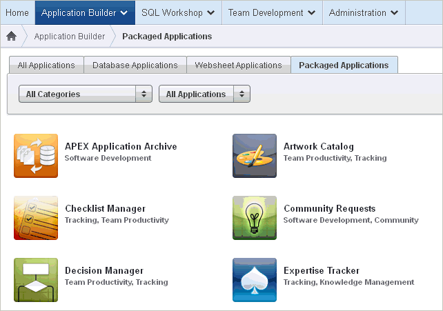

Accessing the Packaged Applications Page
To access the Packaged Applications page:
  1. Log in to Oracle Application Express.
    The Workspace home page appears.
  2. Click the Application Builder icon.
    The Application Builder home page appears.
  3. Select the Packaged Applications tab.
    The Packaged Applications page appears.
    Note that the application category (for example, Software Development or Sample Websheet) displays beneath the application title. You can identify installed applications by the green Installed tag that displays beneath the product category.
  4. Use the following lists at the top of the page to filter the display:
    • Category - Sort by application category. Options include: Community, IT Management, Knowledge Management, Marketing, Project Management, Sample, Software Development, Team Productivity, Tracking, and so on.
    • Type - Sort by application type. Options include: All Applications, Only Installed, Not Installed, Database Applications, or Websheets
  5. To view information about a packaged application, or install or remove a previously installed packaged application, click the application image.
