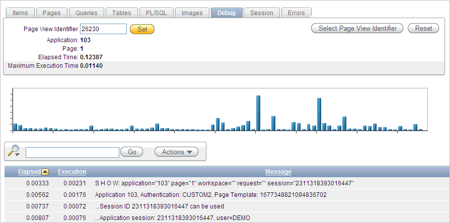

Click the View Identifier to the left of the session you want to view.
The following illustration shows debug reports viewed in the Item Finder.
To view steps that took the longest, hover over that step on the graph above the report.
The step details display.
To go to that step in the report, click on the bar.
