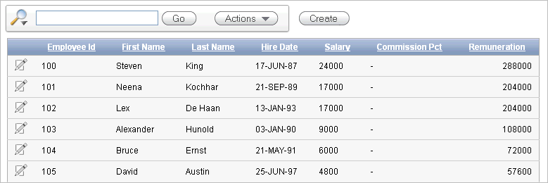

Adding an Employees Report and Form: Build an Employee form and report based on the OEHR_EMPLOYEES table.
Editing the Employees Report: Add calculated fields to the Employees report.

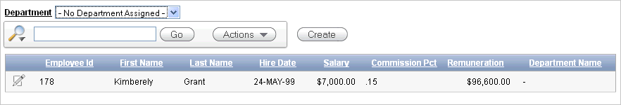

Adding a List of Values to the Employees Report: Add a report as a region that displays department details.

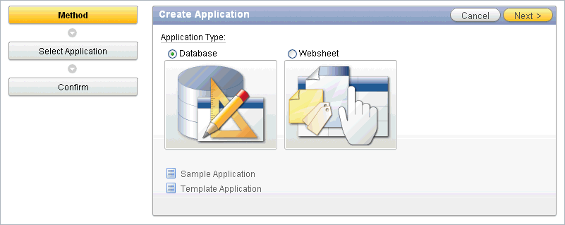

Click the Create button.
The Create Application Wizard appears.
Note that each page within a wizard displays the title of the wizard (for example, Create Application). Each wizard page also displays a series of blocks on the left, representing the sequence of steps. The highlighted block indicates the step you are performing.
To orient you, each step in these exercises generally begin with the block label. For example, the first step in the Create Application Wizard highlights the word Method. Therefore, the next step orients you by beginning with the words For Method.
For Method, select Database and click Next.

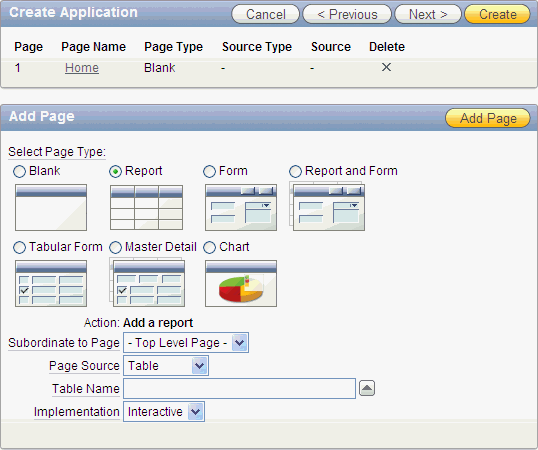

Next, add a page to your application.
For Pages, specify the following in the Add Page section:
Select Page Type - Accept the default, Blank.
Tip:
Explanatory information for each option in item Help. When help is available, the item label changes to red when you pass your cursor over it and the cursor changes to an arrow and question mark.Page Name - Enter Home.
Click Add Page.
The Home page is now listed in the top area. Also, note that the Add Page area appears so you can continue adding pages to your initial application.
Next, add a report page on the OEHR_DEPARTMENTS table.
In the Add Page section, specify the following:
Select Page Type - Select Report.
Subordinate to Page - Select Home (1).
This sets up the hierarchy among the pages in your application.
Page Source - Accept the default, Table.
Table Name - Select OEHR_DEPARTMENTS.
The list shows all tables and views in the schema associated with the application.

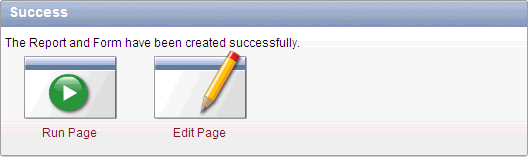

Click Add Page.
Notice that the pages listed in the Create Application section reflect the hierarchy of the pages in your application.
Next, change the default page name, OEHR_DEPARTMENTS, to Departments.
Click the Oehr Departments link.
Under Page Definition, change the Page Name to Departments and click Apply Changes.
In the Create Application section, click Next.

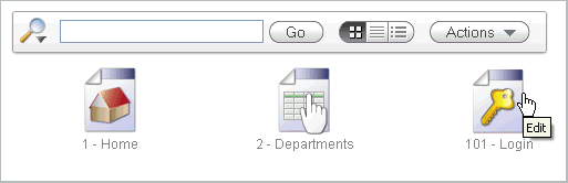

The two pages you created, Home and Departments, appear as icons by default.
To view the pages in a report instead of as icons, click the View Report icon. Your view setting is retained from session to session.Because these steps use the default setting, switch back to Icons view before continuing.

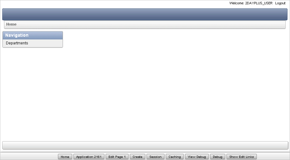

On the Application home page, click Run Application.
The first time you run an application you are prompted to enter a user name and password. To continue, simply enter your workspace user name and password and then click Login.
You can run the application using your Application Express login credentials because you chose Application Express Authentication when creating the application. For more information, see "Establishing User Identity Through Authentication" in Oracle Application Express Application Builder User's Guide.

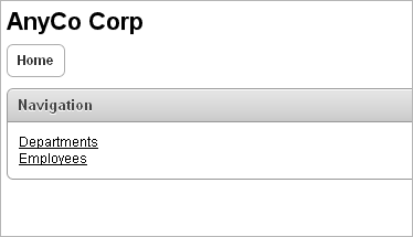

The Home page of your application appears.
Notice that a link to the Departments page appears on the Home page because you set up that hierarchy.
Also notice the Developer toolbar at the bottom of the page. These links appear when you run an application within the development environment. The Developer toolbar offers a quick way to edit the current page, create a page, region, or page control, view session state, or toggle in and out of Debug mode.

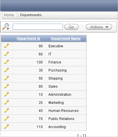

The Departments report appears.

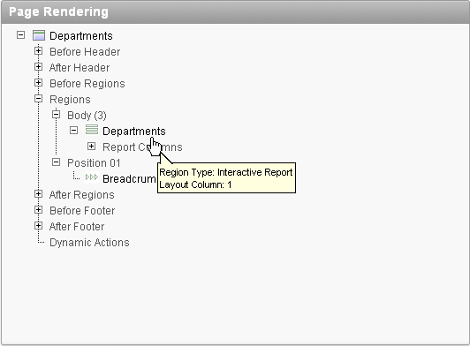

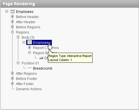

Under Page Rendering, locate Regions.
Expand Region and locate Departments.
Right-click Departments and select Edit.
Tip:
You can also double-click Departments.The Region Definition appears.

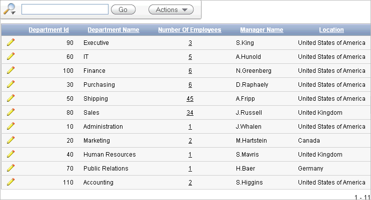

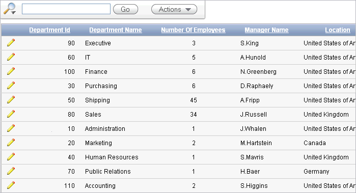

To see how the page looks to end users, run the page. When you run a page, the Application Express engine dynamically renders and processes the page to display viewable HTML.
To run the page:
Click the Run Page icon in the upper right corner.

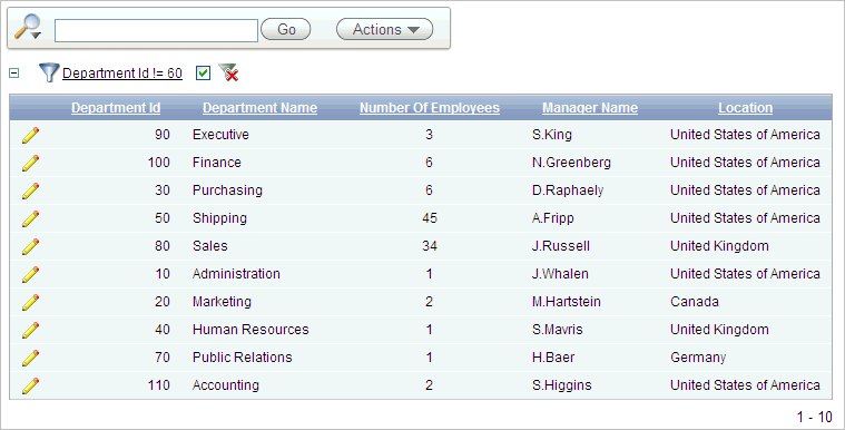

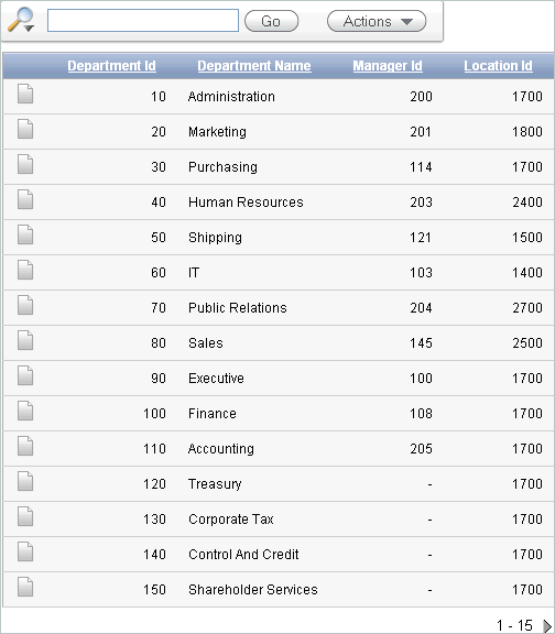

The revised Departments report appears.
Note that the Manager Id and Location Id columns are not available. Also note that the three new columns do not display on the revised report: Number of Employees, Manager Name, and Location. The following steps are required to add these columns to the display and reorder them.

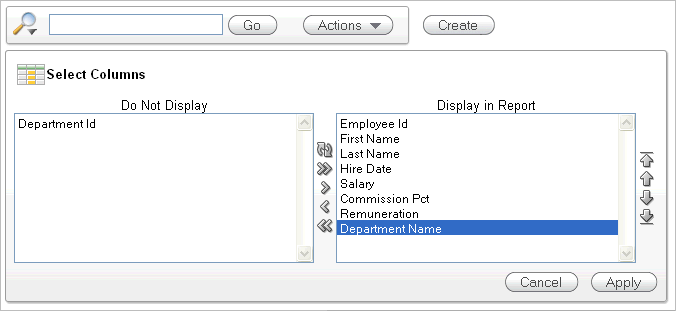

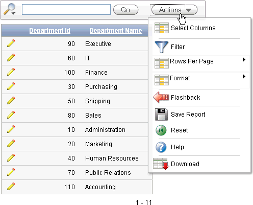

To add the new columns, click the Actions menu.
The list of Action options appears.
From the Actions menu, select Select Columns.

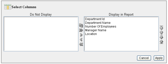

The columns that were added by the new SQL query are in the Do Not Display box.
Click the Move All icon to add these three columns to the Display in Report box. The Move All icon looks like the following figure. ![]()
Verify if the columns are in the following order. If they are not, click up and down arrows to the right of the Display in Report to change the order:
Department ID
Department Name
Number of Employees
Manager Name
Location
Click Apply.
The Departments page appears and includes the new columns.

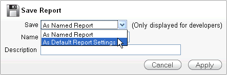

To save current report settings as the default:
Click the Actions menu.
Select Save Report.
The Save Report settings appear.
From Save, select As Default Report Settings.
The Default Report Type settings appear
Select Primary and click Apply.
The report will show all columns when the user selects the Reset option from the Actions menu or when the page is reset by a Reset Interactive Report command, RIR.

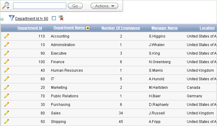

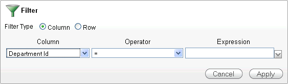

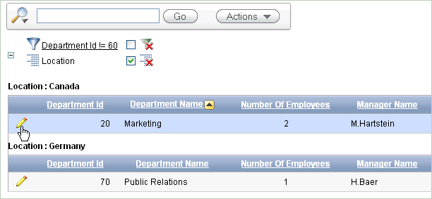

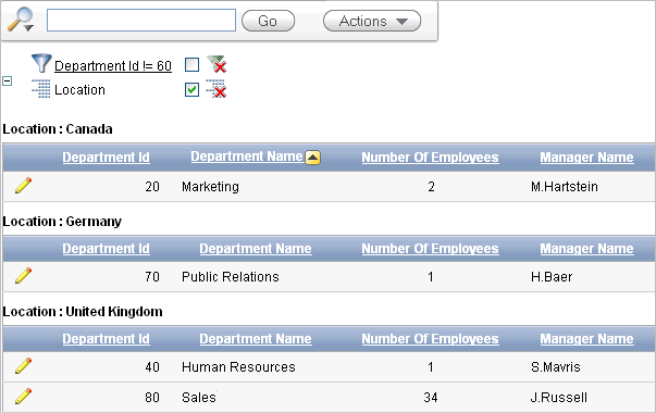

To create a filter for all departments not equal to 60:
Select Filter.
The filter settings display. Note you can also click the column heading link to create a filter for that column. Creating a filter from the column heading menu, however, is limited to the equal operator.
From Operator, select the not equals operator (!=).
From Expression, select 60.
Click Apply.
The Departments report is displayed with the Department_Id!=60 filter applied. All departments, accept for the IT department with a Department Id of 60, are included in the report.
Notice the filter displays at the top of the report. You can edit, disable, or delete this filter. To edit, click the filter name. To disable, deselect the check box. To delete, click the Delete icon that looks like an X over the filter icon.
Deselect the check box next to the Department Id!=60 filter to disable it.
The report shows data for all Department Ids.

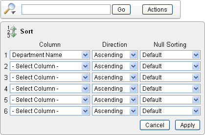

In this exercise, you learn how the user can reorder the data for each column.
To change the sort order:
Select Format and then Sort.
The sort settings are displayed. Note this option is also available for each column by clicking the column heading. The Actions menu is quicker when changing the sort order for multiple columns.
Select Department Name for the first column entry.
Click Apply.
The report shows the Department Name column in ascending alphabetical order.
Notice the up arrow icon after the Department Name that indicates the column has been sorted in ascending order. You can click this arrow to resort the column.
Another way to reformat a report is to create a controlled break. A controlled break enables the user to delineate data into clearly visible groups.
To add a controlled break:
Click the Location column heading.
The column heading menu appears.
Click the Control Break icon as shown below.
Note this same option is also available from the Actions, Format menu.
The report is reformatted to show a break after each group of rows that share the same location.
Note the Location control break report setting displays under the Search bar.

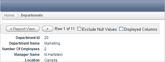

You can also display details for a row by selecting the Single Row icon.
To display the single row view:
Locate the Single Row View icon for the first row.
Select the Single Row View icon for the first row.
The details page for the first row appears.
You can revert the report settings back to the saved default settings. When an interactive report is reset, the default settings are applied to the report. An interactive report can be reset by the user and by the developer under the following conditions:
A user can reset an interactive report if the Reset option is available from the Actions menu. This option is enabled or disabled by the developer. For further details see "Customizing Interactive Reports" in the Oracle Application Express Application Builder User's Guide.
A developer can specify that an interactive report be reset when it is called from another page. The Reset Interactive Report command, RIR, is used for this purpose. For further details see "Customizing Interactive Reports as a Developer" in the Oracle Application Express Application Builder User's Guide.
To return to the default settings:
Click the Report View button.
Click the Actions menu and select Reset.
When prompted to restore the default settings, click Apply.
The report goes back to the default report settings saved in the previous section.

For Confirm, verify the information and click Finish.

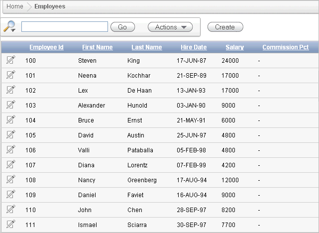

To preview the two pages you just created, run the current page. From the Employees report, you can then preview the form.
To preview the pages:
Click the Run Page icon.
The Employees report appears.
Note the following about the Employees report:
The Search Bar with the Actions menu appears at the top. For more information, see "Using an Interactive Report".
The column headings are links that enable the user to quickly perform various sorting, filtering, and reformatting operations. For more information, see "Using an Interactive Report".
The Edit icon you selected appears in each row. You can click the Edit icon to update the employee record. Since you created a form based on a table with a report, the wizard automatically linked the report to the form. If you create just a report, as described in the previous section, "Creating the Initial Application", the wizard automatically links the report to the single row view.
The Create button appears in the upper right corner. You can click the Create button to add an employee to the underlying table.
The Employees report includes the six columns you specified. When you selected the columns and applied the changes, Oracle Application Express created the appropriate SQL code in the background to produce this result.
Your data might appear in a different order. If so, ignore this difference and continue with these steps.

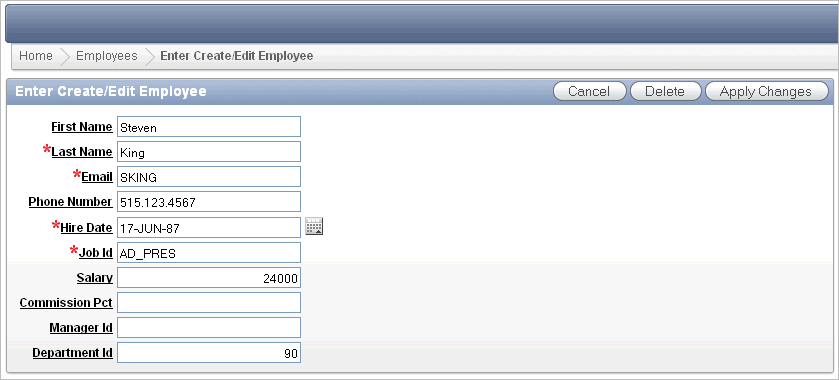

To review the form you also created, click the Edit icon in an Employee row.
The Create/Edit Employee form appears.
Note the following about the Create/Edit Employee form:
The form includes Cancel, Delete, and Apply Changes buttons.
The Hire Date field displays a calendar, which is included because the data type of the underlying column is DATE.
Fields labeled in red require are mandatory and cannot be left blank or null.

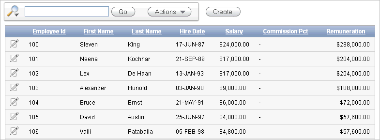

In this exercise, you create a new column entitled Remuneration to display employee salaries in the Employees report.
First, create a function to calculate employees' salaries.
To create a function:
Click the Home link on the Developer toolbar.
Click SQL Workshop and then SQL Commands.
SQL Commands provides a window where you can run PL/SQL against the database.
In the SQL editor, enter the following script:
CREATE OR REPLACE FUNCTION calc_remuneration(
salary IN number, commission_pct IN number)
RETURN NUMBER IS
BEGIN
RETURN ((salary*12) + (salary * 12 * nvl(commission_pct,0)));
END;
When copying and pasting this SQL, make sure there is not an empty line before the first statement, CREATE OR REPLACE FUNCTION.
Click Run.
The Results section displays this message:
Function created.
Next, add a column to display the results of the employees' salary calculations.
To add a column:
Navigate to the Page Definition for page 3:
Click the Application Builder tab.
Select the AnyCo Corp application.
Click 3 - Employees.
The Page Definition for page 3 appears.
Under Regions, locate Employees.
Right-click Employees and select Edit.
Scroll down to Source, and replace the existing code with the following:
SELECT "EMPLOYEE_ID",
"FIRST_NAME",
"LAST_NAME",
"HIRE_DATE",
"SALARY",
"COMMISSION_PCT",
calc_remuneration(salary, commission_pct) REMUNERATION
FROM "#OWNER#"."OEHR_EMPLOYEES"
Click Apply Changes.
Click Apply Changes to confirm.

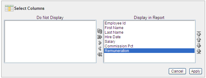

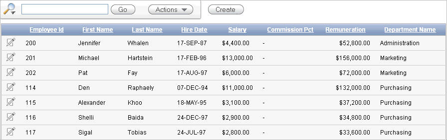

To preview the page, click the Run Page icon in the upper right corner. Notice the Remuneration column does not appear. You must add the column by using the Select Column action.
To display the Remuneration column:
Select the Select Columns action.
Move the Remuneration column from the Do Not Display box to the Display in Report box.
Click Apply.
The Employees Report is displayed and includes the Remuneration column.

In this exercise, you add a link on the Home page to take users to the Employees report. This link appears in the Navigation region on the left side of the Home page.
To add a link on the Home page to the Employees report:
Navigate to the Page Definition for the Home page, page 1:
Click the Application ID link on the Developer toolbar (at the bottom of the page).
On the Application home page, click 1 - Home.
Under Regions, right-click Navigation and select Edit List.
On the Entries by List page, click the Create List Entry button.
On the Create/Edit List page, edit the following:
Sequence - Change to 20.
List Entry Label - Enter Employees
Page - Select 3.
Click Create.
Run the page.
Notice that your Home page now includes a link to Employees.
Click Employees to test the link.
In this exercise, you link the Employees and Departments reports. When you complete this section, the Employees report will have a Departments column showing which department each employee belongs to.
To perform this task, you create a column on the Employees page to enable the user to select a department. You then run the Employees report and add the Departments column to the report. The report settings are saved as the default.
In order to filter the Employees report by department, add a Department column to the report.

When you first run this report, use the Select Columns action to add the Department Name column to the display. Once this column is visible on the report, make this report the default and filter by department.
To add the Department Name column to the report:
Click the Run Page 3 icon.
Click the Actions menu and select Select Columns.
Move Department Name from the Do Not Display box to the last entry in the Display in Report box.
Click Apply.
The Employees Report is displayed and includes the Department Name column.

This section describes how to save the current report settings as the Primary Default report. Report settings are any setting made through the Actions menu including: selected columns, filters, sorting, rows per page, format setting such as sort control breaks, highlighting, and so on, and flashback.
Both developers and end users can save interactive reports. However, only a developer can save the report that initially displays, called the Primary Default report.
Once the default settings are saved, these columns are the default display in this report.
To save the current report settings as the default:
Run the Employees report page.
The current report default does not include the Department Name column when the report is displayed.
Select Save Report.
For Save, select As Default Report Settings from the list.
Accept the Default Report Type setting, Primary, and click Apply.
If a reset is performed on this page, these default report settings are used. The Department Name column is displayed by default.In this exercise, you add a link to the Number of Employees column on the Departments report that navigates the user to the Employees report. It also sets the focus to the selected department. The column link includes a Clear Interactive Report command, CIR, to clear the Employees report, when shown, of any filters, control breaks, highlights, aggregates, computed columns, chart settings and flashback settings.
To make this change, you edit the report attributes on the Departments report to change the value for the Number of Employees column to a link.
To change the column value to a link:
Click the Application ID link on the Developer toolbar.
Click 2 -Departments.
Under Regions, right-click Departments and select Edit Report Attributes.
The Report Attributes page appears.
Locate the Column Attributes section.

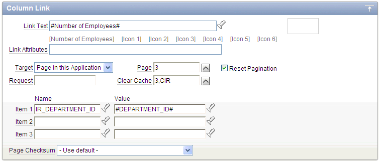

In the Column Attributes section, click the Edit icon next to Number of Employees.
Scroll down to the Column Link section.
Under Column Link, make these changes:
Page - Enter 3.
Select the Reset Pagination check box.
Clear Cache - Enter:
3,CIR
The 3 means the cache for page 3 is cleared and the string CIR clears the Employees interactive report of any filters, control breaks, highlights, aggregates, computed columns, chart settings or flashback settings when the report is displayed.
If you want to reset the interactive report to the default report settings instead of clear the report, replaceCIR with RIR. The last saved default report settings are applied to the interactive report.Item 1, Name - Enter IR_DEPARTMENT_ID
By prefixing the item name with IR_, the URL item will be associated with an interactive report column rather than an item on the page.
Item 1, Value - Select #DEPARTMENT_ ID#
The Column Link section shows all the options you selected.
In summary, these options enable the following behavior when the end user clicks the link:
The end user is navigated to page 3 of the Employees report.
On the Employees report, the selected department is in focus.
The Employees report is cleared. This means any filters, control breaks, highlights, aggregates, computed columns, chart settings or flashback settings are removed.
The user is returned to the first set of employee records when the user selects another department.
Note that in the Column Attributes section, the Number of Employees row contains a check mark in the Link column, reflecting the change you just made.

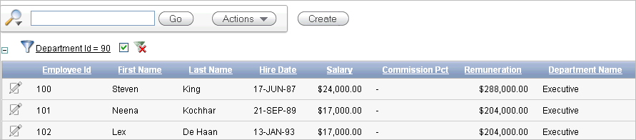

Now, run the report and test the Number of Employees column link from the Departments report. The Employees report is displayed showing all employees that belong to the selected department.
Click the Run Page 2 icon.
The Departments report is displayed. Note that end users can now drill down on the data in the Number of Employees column.
In the Number of Employees column, click the 3 for the Executive row.
All employees that belong to the Executive department appear in the Employees report.
The Department Id filter is displayed because this report is filtered by the Department Id value for the Executive department, 90, passed to this report from the Departments report. Notice the Clear Interactive Report command is included at the end of the URL in your browser, as shown in this example:
f?p=9257:3:3672543193352902::NO:RP,3,CIR:IR_DEPARTMENT_ID:90

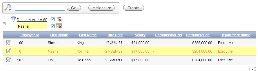

This exercise demonstrates how to use the CIR command to clear a highlight before displaying the Employees report. To show this, you highlight any rows containing the first name of Neena, then display the Employees report from the Number of Employees column on the Departments report.
To highlight rows in the Employees report:
Click the Actions menu and select Format and then Highlight.
The Highlight options appear.
For Highlight options make these changes:
Name - Enter Neena
Background Color - Select [yellow]
Text Color - Select [red]
Column - Select First Name
Operator - Select =
Expression - Select Neena
Click Apply.
The Employees report appears with the row for Neena highlighted.
Next, reset the report.
Click the Home breadcrumb.
Click Departments link.
Click Number of Employees in the Executive row.
The Employees report is displayed with the highlighting cleared, due to the CIR command specified in the column link.
Click the Remove Filter icon to the right of DepartmentID = 90.

Navigate to the Page Definition for page 3, Employees.
Under Region, right-click Employees and select Create Page Item.

Because the Employees query has changed, the Number of Employees column link needs to initialize the P3_DEPARTMENT_ID item to the value of DEPARTMENT_ID.
To change the column link for Number of Employees:
Click the Application ID breadcrumb.
Click 2 - Departments.
Click the Edit icon for Number of Employees.
Scroll down to Column Link.
For Item 1, select P3_DEPARTMENT_ID.

Run the page.
From the Department list, select No Department Assigned.
Employee Kimberely Grant appears. This employee is not currently assigned to a department.
Tip:
If no records initially display, reload the page and try again.You can add a graphical logo or text to your application so that it displays on each page. Your page template determines the display location.
In this exercise, you add your company name to your application.
To add your company name to your application:
Navigate to the Application home page. Click Application ID on the Developer toolbar (at the bottom of the page).
Click the Edit Application Properties button.
The Edit Application Definition page appears.
Under Logo:
Logo Type - Select Text.
Logo - Enter AnyCo Corp
Logo Attributes - Select Black Text from the pop up list.
Click the 1 - Home.
The company name now appears on each page in your application.
