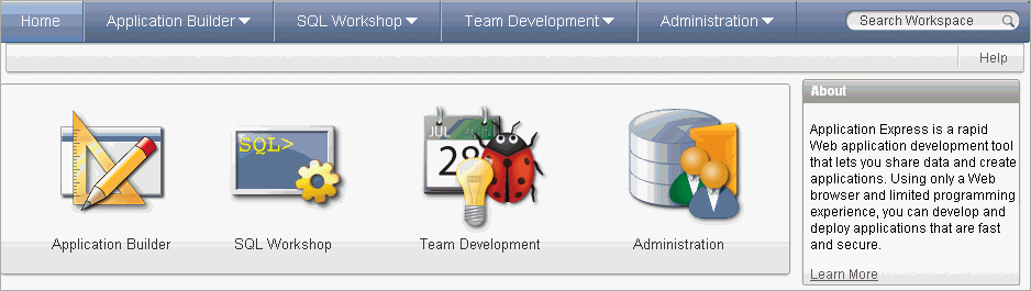

When you log in to Oracle Application Express, the Workspace home page appears.
Take a few minutes to explore the product. The following large icons display in the center of the page:
Application Builder. Use Application Builder to assemble an HTML interface (or application) on top of database objects such as tables and procedures.
SQL Workshop. Use the SQL Workshop to access tools for viewing and managing database objects.
Team Development. Use Team Development to track new features, non-feature to do tasks, bugs, and milestones. Users can also provide real-time feedback which then can be categorized into features, to do tasks, or bugs.
Click the Learn More link in the About box to view an informative introduction to Oracle Application Express. Topics covered include architecture, self service, security, Websheets, application development, SQL Workshop, Team Development, administration, and managing development.

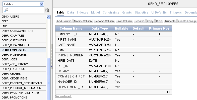

Review the objects you just created by going to Object Browser. Object Browser enables you to browse, create, and edit objects in your database.
To view the objects:
On the Workspace home page, click SQL Workshop.
Click Object Browser.
Object Browser appears.
Object Browser is divided into two sections:
Object Selection pane displays on the left side of the Object Browser page and lists database objects of a selected type within the current schema.
Detail pane displays to the right of the page and displays detailed information about a selected object.
From the list in the Object Selection pane on the left, select Tables.
The Detail pane lists the tables in your current schema.
In the Object Selection pane, click OEHR_EMPLOYEES from the list.
The Detail pane shows details about the table.
Click the Data tab at the top of the Details pane.
The data in the OEHR_EMPLOYEES table appears. Note that other tabs show additional details about the object you select.
To search for an object name, enter a case-insensitive term in the Search field.
To view all objects, leave the Search field blank.
