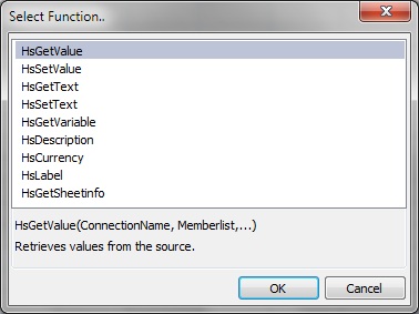

  5. In Select Function, select a function from the list and click OK.
    Figure 39. Function Builder, Select Function Dialog Box
    The Function Builder, Select Function dialog box, with HsGetValue, selected as described in this section

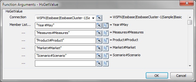

    Figure 40, Function Builder, Function Arguments Dialog Box for HsGetValue Based on the Essbase Sample Basic Database shows a completed Function Arguments dialog box for the HsGetValue function.
    Figure 40. Function Builder, Function Arguments Dialog Box for HsGetValue Based on the Essbase Sample Basic Database
    The Function Builder, Function Arguments dialog box for the HsGetValue function, with a Connection field and fields for entering dimensions and members for each function argument.
    The arguments listed in Function Arguments vary depending on the function selected in step 5.
