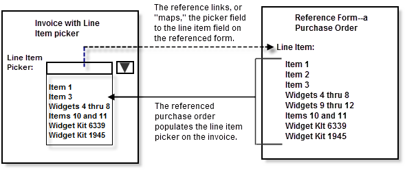

Primavera Unifier populates the data in some pickers with a reference process form. Reference processes are necessary  for any form that uses BP or line item pickers. Primavera Unifier users use these pickers to call data from another—a referenced—business process. The reference establishes a link between the records (for example, an invoice record to a purchase order). Because of this link, record to record, you can populate one form with data from other forms.
To make these pickers effective, you must connect both forms by “mapping” a field on the picker to one on the referenced form. In operation, the picker will point to the referenced form and use the values in the fields you specify to display data on the picker. Once the reference link is created, you can use the referenced form to populate any data elements that the referenced and current form have in common.
Likewise, if a form includes a line item picker, the user can select specific line items from a referenced form. To make a line item picker effective, you must specify what line items the user can select from the referenced form. Once you do this, the referenced line items will automatically populate those line item fields that the referenced and the current form have in common.
For asset classes, you can reference only other company-level business processes.
To populate pickers, the data definition of both fields—the one on the picker as well as the one on the referenced BP— must match.
