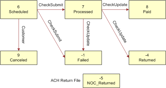

Check Payment Status Workflow
Check Payment Status Workflow updates the check payment status at different stages of check payment processing. Figure 9 shows the states that a check can be in, and the jobs that change the state.
Figure 9. Check Payment Status Workflow
Table 66 lists the statuses that can occur during a check payment transaction cycle. The values in parentheses () are the values saved in the Oracle Self-Service E-Billing database
Table 66. Check Payment Transaction Status
Scheduled(6) |
A customer scheduled a new check payment. |
Processed(7) |
Oracle Self-Service E-Billing Payment processed a check and sent it to the ACH gateway. |
Paid(8) |
ACH paid or cleared a check. |
Cancelled(9) |
The customer cancelled a check. |
Failed(-1) |
ACH failed to pay a check failed for a reason other than returned. |
Returned(-4) |
ACH returned a check. |
noc_returned(-5) |
This customer's payment account information must be changed. |
