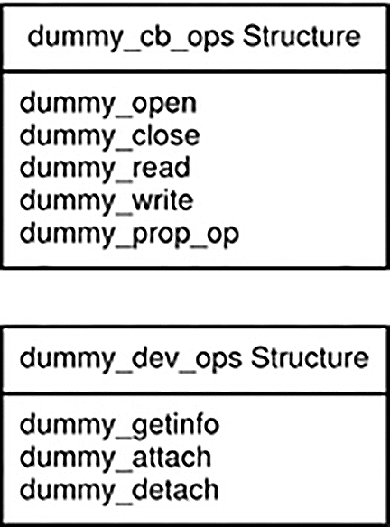

The entry points that are to be created in this example are shown in the following diagram.
Figure 4  Entry Points for the dummy Example
image:Diagram shows the entry points that are to be created in the dummy examples.
