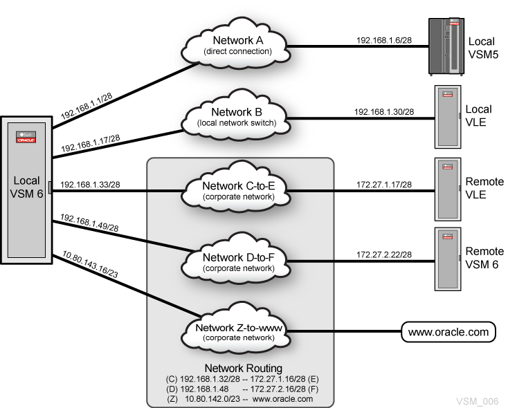

The example node configuration shown in Figure 6-2 covers all three scenarios:
  • The first replication port (network A) is connected directly to a local VSM 5 IFF port.
  • The second replication port (network B) is connected to a local VLE port through a switch.
  • The third replication port (network C) targets a remote VLE port on a different network.
  • The fourth replication port (network D) targets replication ports on a remote VSM 6 port on a different network.
  • ASR traffic (network Z) is sent to Oracle
Figure 6-2 Node Configuration Example
Surrounding text describes Figure 6-2 .

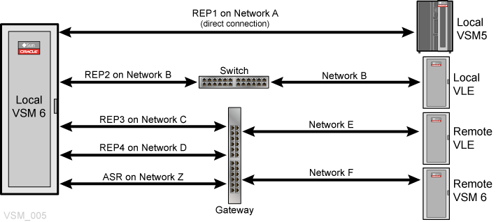

Direct, Switched, and Gateway Configuration Scenarios
Figure 6-3 shows a network with a direct connection, a network with a switch connection, and three networks with connections through a gateway.
Figure 6-3 Example Direct, Switched, and Gateway Connection Scenarios
Surrounding text describes Figure 6-3 .

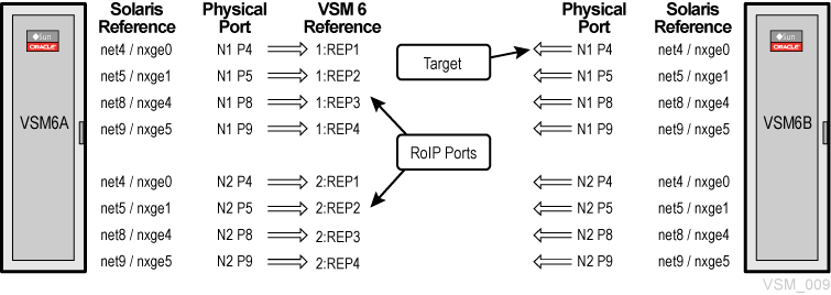

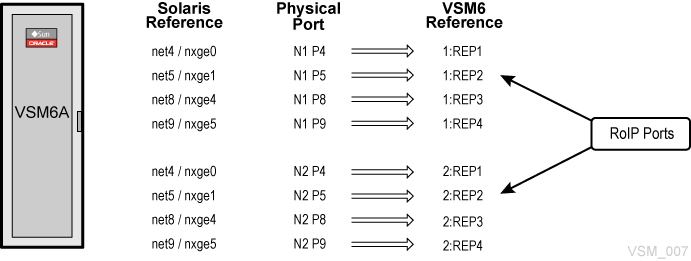

VSM 6 IP Replication: Define the Replication Ports
  • Each port defined as an RoIP is just a route out from the VSM 6.
  • The number of RoIP routes defined does not relate to the IPPATHs defined for the vRTD/CLINKs.
  • Multiple RoIP ports provide bandwidth and resilience.
Figure 6-4 VSM6 IP Replication – Define the Replication Ports
Surrounding text describes Figure 6-4 .
VSM 6 CLI Example:
vsmadmin: update ipport –name 1:REP1 –ip 35.107.24.1/24
vsmadmin: update ipport –name 2:REP2 –ip 35.107.25.2/24

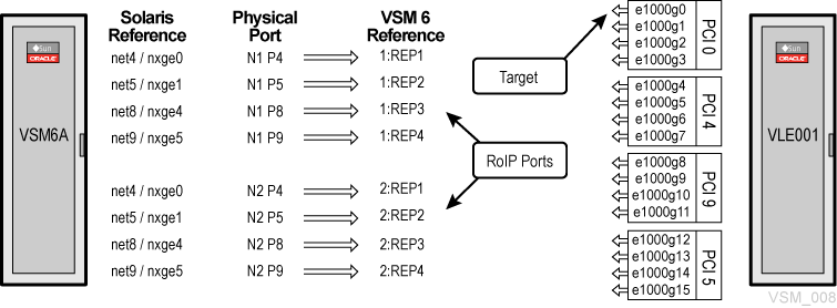

VSM 6 VLE Connectivity: Define the IPPATH
  • VTCS uses the VLE name of the target defined on the IPPATH command used in the VSM 6 CLI. Each IPPATH is just a route out of the VSM 6 to the VSM target.
  • vRTDs are defined to VTCS as IP devices with IPIF ids.
  • The IPIF id is not used to reference the definition but must be present to meet VTCS syntax rules. Each IPIF id must be unique and with valid syntax for each VSM 6 defined in VTCS.
  • VTCS allows 16 IPIF ids total, so each VSM 6 can have a maximum combined total of 16 IP vRTDs/CLINKS in any combination.
Figure 6-5 VSM6 VLE Connectivity – Define the IPPATH
Surrounding text describes Figure 6-5 .
VSM 6 CLI Example:
vsmadmin: add ippath –target vle -name V6VRTD00 –ip 35.107.22.10
VTCS Example:
RTD NAME=V6VRTD00 STORMNGR=VLE001 IPIF=0A:0
