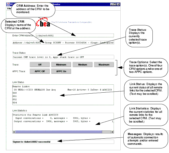

Figure 3-1 shows an example of the CRM Monitor display.
Figure 3-1 CRM Monitor Display
CRM Monitor Display
After you launch the CRM Monitor, use the following instructions to set CRM Monitor options:
  1. To monitor a CRM, type the CRM address in the Enter CRM Address text box using the following format:
  2. //host:port
    where host explicitly specifies the CRM host machine and port specifies the port number of the CRM on the CRM host machine.
    This value may only be entered once per started instance of a CRM Monitor.
  3. Select one of the following trace options for the CRM:
    • Stop CRM Trace disables CRM tracing and closes the trace file, if it exists. This option is trace level 0 as described in the Trace Options section for the CRM command.
    • Set Minimum CRM Trace establishes tracing of only major events. This level is sufficient only to determine the sequence of application conversations. This option is trace level 1 as described in the Trace Options section for the CRM command.
    • Set Medium CRM Trace establishes tracing of major events plus tracing of all I/O buffers. This option is trace level 2 as described in the Trace Options section for the CRM command.
    • Set Maximum CRM Trace establishes tracing of major events and all I/O buffers, plus tracing of all APPC verbs. This option is trace level 3 as described in the Trace Options section for the CRM command.
    • Note: The CRM Monitor does not show trace data. This data is captured in a file under the APPDIR directory of the CRM server (APPDIR is the variable name associated with the CRM directory). Please contact Oracle Customer Support for help in locating the trace file(s) and interpreting them.
      Note: The time tag information in the CRM trace should reflect the current system time. In order to make use of the correct time zone information on UNIX and MVS systems, it is important that the TZ environment variable be set correctly. If this variable is not set correctly on your system, refer to your system documentation for further information.
  4. Select one of the following APPC stack trace options:
    • Start APPC Stack Trace establishes tracing of the APPC stack. This option generally shows the parameters and results of all API calls. Depending on the stack being used, other options such as vendor-specified environment variables also may have to be activated. This option may be selected along with any of the previous Trace Options. This option corresponds to the -s option as described in the CRM section.
    • Stop APPC Stack Trace disables APPC stack trace, if established.
    • Note: Trace options for the CRM and APPC Stack API trace options may also be set from the CRM command. Refer to the CRM section for more information about trace options.
  5. After you enter a CRM address and select trace options, the following fields display information about the CRM you are monitoring:
  6. Display Field
    Description
    Selected CRM
    Displays the name of the CRM at the address entered in the address field.
    Trace Status
    Displays the currently selected trace options.
    Link Status
    Displays the current status of all remote links for the selected CRM. (Text may be scrolled.)
    Link Statistics
    Displays the current statistics for all remote links for the selected CRM. (Text may be scrolled.)
    Message Line
    Displays messages showing either the results of automatic connection attempts or commands issued to change the trace options.
