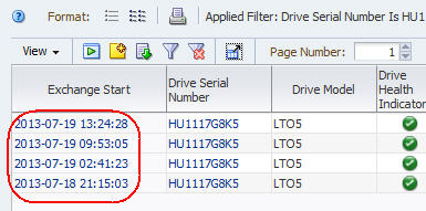

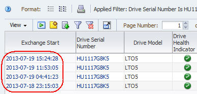

The following figures show the same exchange data with two different time zone settings.
Figure 2-1 Exchanges With Time Zone Set to US/Eastern
Figure 2-2 Exchanges With Time Zone Set to US/Mountain (Two Hours Earlier)

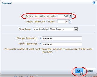

Use this procedure to set the screen display refresh rate for your STA username in this and future login sessions. STA screens will be updated to display new data at the frequency you specify. The default is 480 seconds. See "Screen Refresh Interval" for details.
Select Preferences > General from the Main Toolbar.
The General dialog box appears.
In the Refresh interval in seconds field, enter the new refresh rate want to assign, and then click OK.
The settings take effect immediately. They remain in effect for this and future login sessions, until you change them again using this procedure.

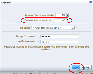

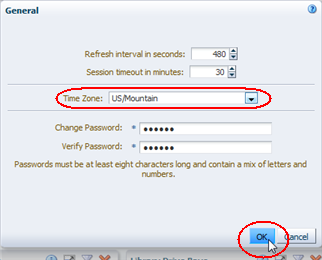

Use this procedure to set the timeout period for your STA username in this and future login sessions. If your login session is idle for longer than this amount of time, your session will be ended. The default is 30 minutes. See "Automatic Timeout Interval" for details.
In the Session timeout in minutes field, enter the timeout period you want to assign, and then click OK.
The settings take effect immediately. They remain in effect for future login sessions, until you change them again using this procedure.
Use this procedure to change the time zone setting for your STA username. All dates and times are displayed in the time zone you specify. See "Time Zone Options" for additional information.
In the Time Zone menu, select the time zone you want to use, and then click OK.
To have STA automatically detect your local time zone based on your computer's system clock, select <Auto-detect Time Zone>.
Data in all STA screens is immediately displayed in the new time zone. The time zone setting remains in effect for future login sessions, until you change it again using this procedure.

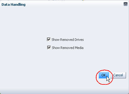

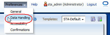

Use this procedure to customize the removed drives and media display settings for your STA username in this and future login sessions. These settings control how removed drives and media are displayed by the STA user interface. See "Removed Drives and Media Display Options" for details.
Select Preferences > Data Handling from the Main Toolbar.
The Data Handling dialog box appears.
Select the appropriate check boxes to enable the display of removed drives, media, or both.
Verify your selections and then click OK.

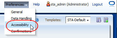

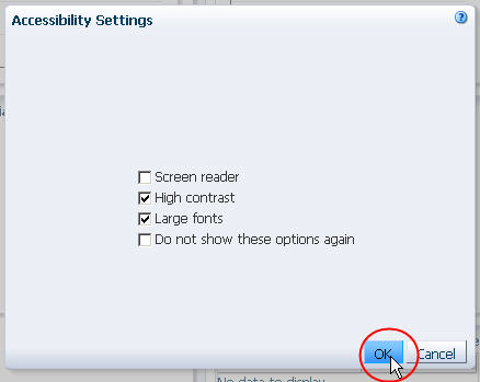

Use this procedure to customize the accessibility settings for your STA username in this and future login sessions. See "Accessibility Options" for details.
Select Preferences > Accessibility from the Main Toolbar.
Note: If the "Do not show these options again" check box is not selected, then this screen appears automatically whenever you log in to STA. |
The Accessibility Settings dialog box appears.
Select the appropriate check boxes to enable the accessibility modes you want to use. Options are:
Screen Reader – Causes the screen display to be optimized for use with screen readers such as JAWS. It also allows you to perform all screen actions with the keyboard instead of a mouse.
High Contrast – Causes STA screens to be compatible with high-contrast features provided by your browser. For best results, you may also want to enable large fonts mode, described below.
Large fonts – Causes STA screens to be compatible with larger font sizes and zoom capabilities provided by your browser. For best results, you may also want to enable high-contrast mode, described above.
Do not show these options again – Indicates that you do not want this dialog box to be displayed automatically when you log in. If you apply this option, this dialog box will be skipped for all future times that you log in to STA. You can use this procedure to reset this option at any time.
The STA screen display is immediately modified according to your selections. These settings remain in effect for future login sessions, until you change them again using this procedure.

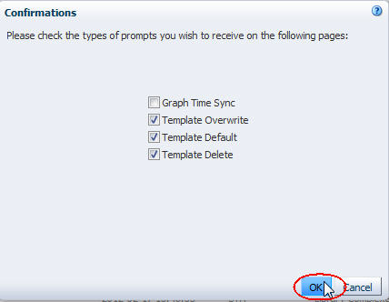

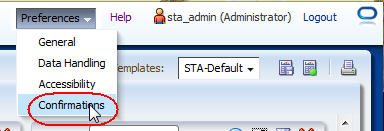

Use this procedure to customize the display of selected confirmation dialog boxes for your STA username in this and future login sessions. See "Confirmation Dialog Box Options" for details.
Select Preferences > Confirmations from the Main Toolbar.
The Confirmations dialog box appears.
For each option listed, select the check box to display the dialog box or deselect the check box to suppress the dialog box. Options are:
Graph Time Sync – Selecting this check box indicates you want a confirmation dialog box to appear before you synchronize all graphs on a screen to the same date range.
Deselecting this check box indicates you want to suppress the confirmation dialog box. Graphs will be synchronized as soon as you click Synchronize Date Range in the Graph Pane Toolbar.
Template Overwrite – Selecting this check box indicates you want a confirmation dialog box to appear before you save changes to an existing template.
Clearing this box indicates you want to suppress the confirmation dialog box. Existing templates will be overwritten as soon as you click Save in the Save Template dialog box.
Template Default – Selecting this check box indicates you want a confirmation dialog box to appear when you change the default template for a screen.
Clearing this box indicates you want to suppress the confirmation dialog box. The new default template will be set as soon as you click Default Template in the Templates toolbar.
Template Delete – Selecting this check box indicates you want a confirmation dialog box to appear before you delete an existing template.
Clearing this box indicates you want to suppress the confirmation dialog box. Templates will be deleted as soon as you click Delete in the Delete Template dialog box.
