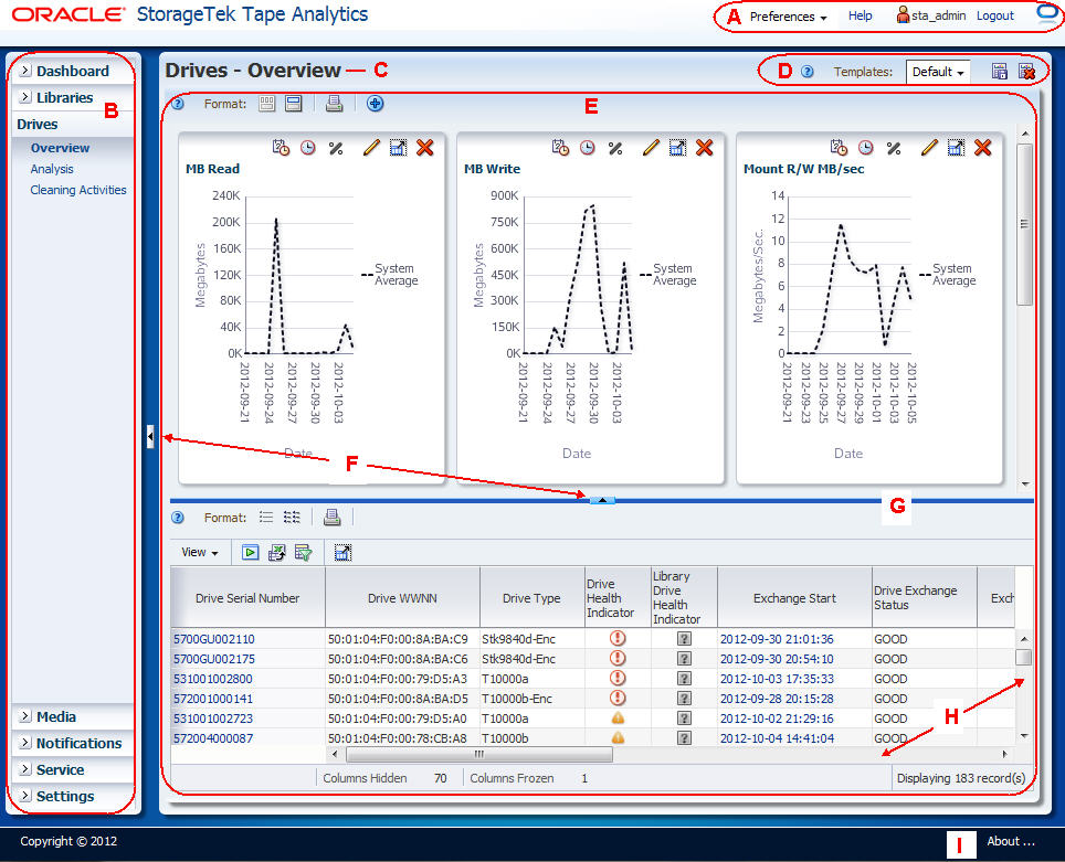

All STA screens follow the same general structure and layout. The main parts are illustrated and described below.
| Item | Name | Description |
| A | Main Toolbar | Provides direct access to frequently used screen-independent commands. See "Main Toolbar" for details. |
| B | Navigation Bar | Primary navigation tool for STA. Provides direct access to all STA screens. See "Navigation Bar" for details. |
| C | Screen Title | Name of the screen. Corresponds to the screen link in the Navigation Bar. |
| D | Templates Toolbar | Provides access to the most frequently used commands for using templates. See the STA User’s Guide for details. |
| E | Main Window | Main focus of the screen, where the STA content is displayed. See "Main Window" for details. |
| F | Collapse Pane icon | Indicates that the pane can be collapsed or resized, either vertically or horizontally. See "Collapse and Restore the Graphics Area" for details. |
| G | Resize control bar | Indicates that the pane can be resized, either vertically or horizontally. Appears when you move the mouse over the space between two resizable screen areas. See "Resize the Graphics and Table Areas" for details. |
| H | Scrollbars | Allow you to scroll vertically or horizontally to display more data. Appear dynamically whenever the screen area is not large enough to display all the data at once. |
| I | About | Displays detailed software version information. See the STA User’s Guide for details. |

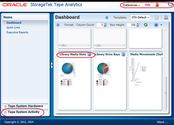

STA provides the following types of screens:
Dashboard

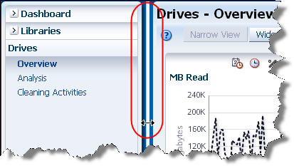

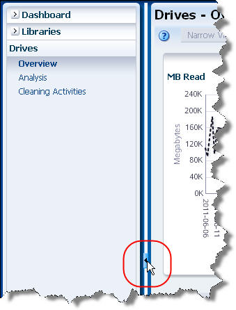

Use this procedure to resize the Navigation Bar and Main Window relative to one another.
Move the mouse over the space between the Navigation Bar and the Main Window, until the vertical Resize control bar and Resize object cursor appear.
Click and drag the control bar until the Navigation Bar and Main Window are the sizes you want, and then release the control bar.

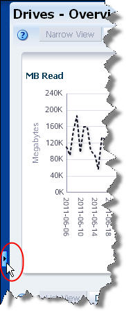

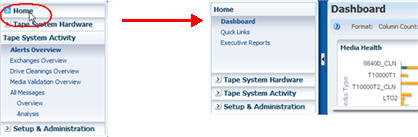

Use this procedure to hide the Navigation Bar and then restore it.
Click the Collapse Pane icon in the space between the Navigation Bar and the Main Window.
The Navigation Bar is collapsed, and the Main Window is expanded horizontally across the entire screen.
To restore the Navigation Bar to its original width, click the Restore Pane icon on the left side of the window.

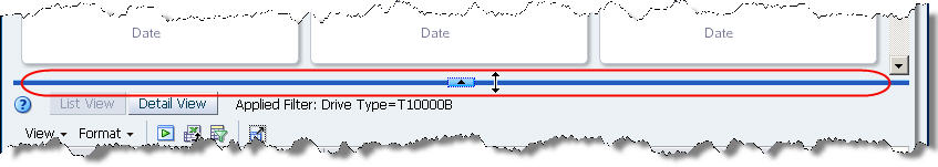

Use this procedure to resize the Graphics and Table Areas relative to one another.

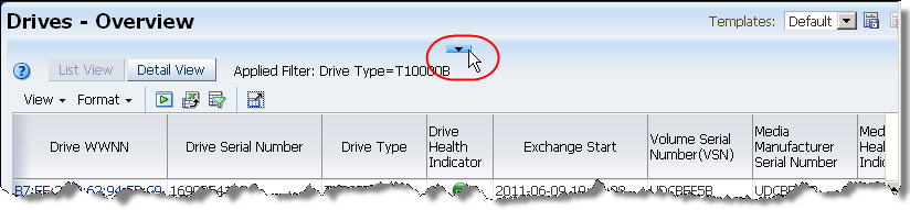

Move the mouse over the space between the Graphics and Table Areas until the Resize Control Bar and Resize object cursor appear.
Note: If the Resize Control Bar does not appear, it could be the Graphics Area has been collapsed, as indicated by the Restore Pane down-arrow icon at the top of the screen. If this is the case, see "Collapse and Restore the Graphics Area" for instructions. |
Click and drag the Resize Control Bar until the two areas are the sizes you want, and then release the mouse. The Collapse Pane icon remains in the up-arrow position indicating the Graphics Area has been resized, not collapsed.

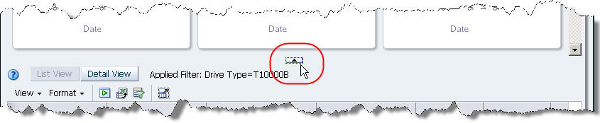

Use this procedure to hide the Graphics Area and then restore it. Collapsing the Graphics Area provides more space in the Main Window for you to view table data.
Click the Collapse Pane icon in the space between the Graphics and Table Areas.
The Graphics Area is hidden, and the Table Area expands vertically over the entire Main Window. The icon changes to the Restore Pane down-arrow icon.
To restore the Graphics Area to the size it was before it was collapsed, click the Restore Pane icon at the top of the Main Window.

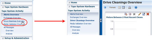

Use this procedure to display screens through the Navigation Bar.
Click a collapsed tab in the Navigation Bar.
The tab is expanded, displaying links to all the screens in the tab.
At the same time, the first screen listed under the tab is automatically displayed in the Main Window. The screen title, at the top left of the Main Window (Alerts Overview in this example) corresponds to your selection in the Navigation Bar.

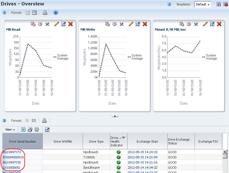

This procedure is an example of using resource ID links to display detail about an individual drive and other resources related to it.
In the Navigation Bar, click Drives to display the Drives – Overview screen.

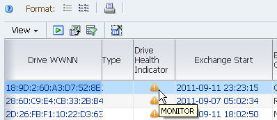

The Drive Serial Number column displays text links for all drives.
Click one of the drive links.

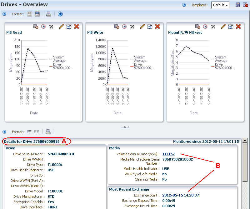

You are taken to the Drives –Overview, Detail View screen, which displays full detail for the selected drive.
A – Detail View header identifies the drive displayed.
B – Related resource ID links appear on the screen.

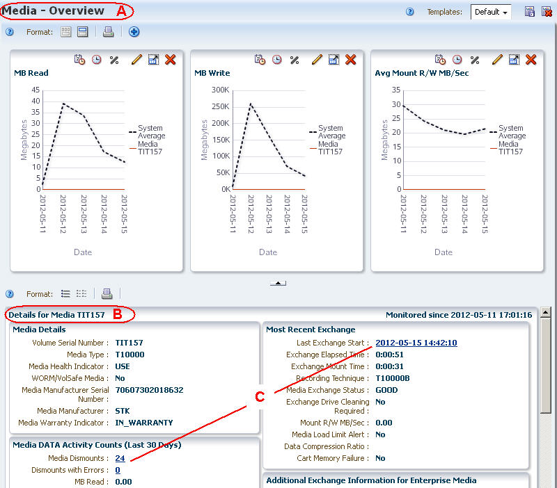

Click the Volume Serial Number link.
You are taken to the Media –Overview, Detail View screen, which displays full detail for the selected media record.
A – Screen title identifies the current screen.
B – Detail View header identifies the media record displayed.
C – Additional resource ID links appear on the screen. You can click any of these links to continue navigation.

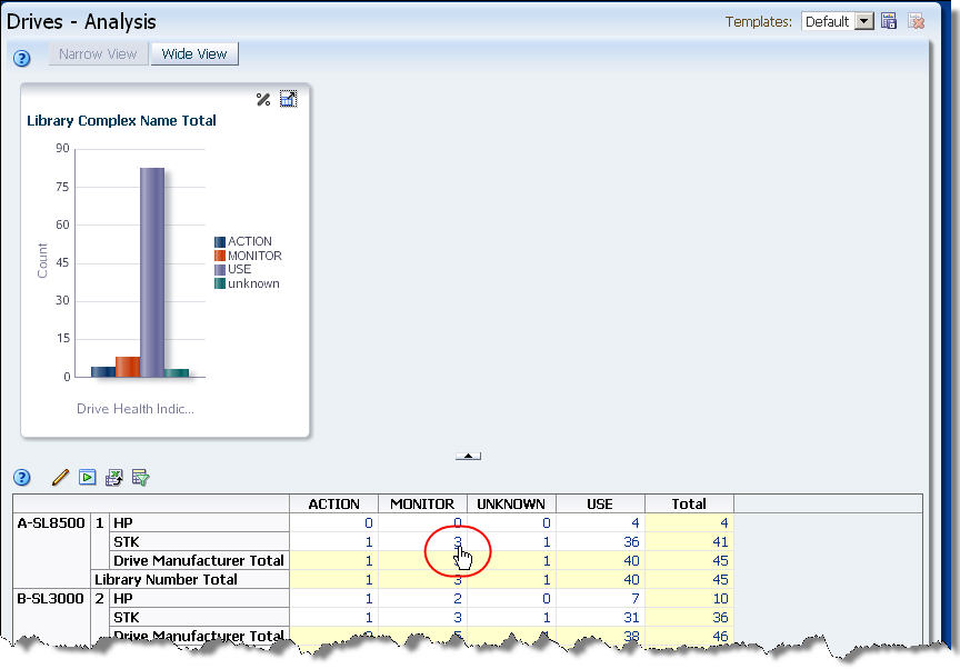

This procedure is an example of how to use aggregate count links to drill down to additional detail about a group of drives included in an aggregate count.
In the Navigation Bar, click the Drives tab and then the Analysis link to display the Drives – Analysis screen.

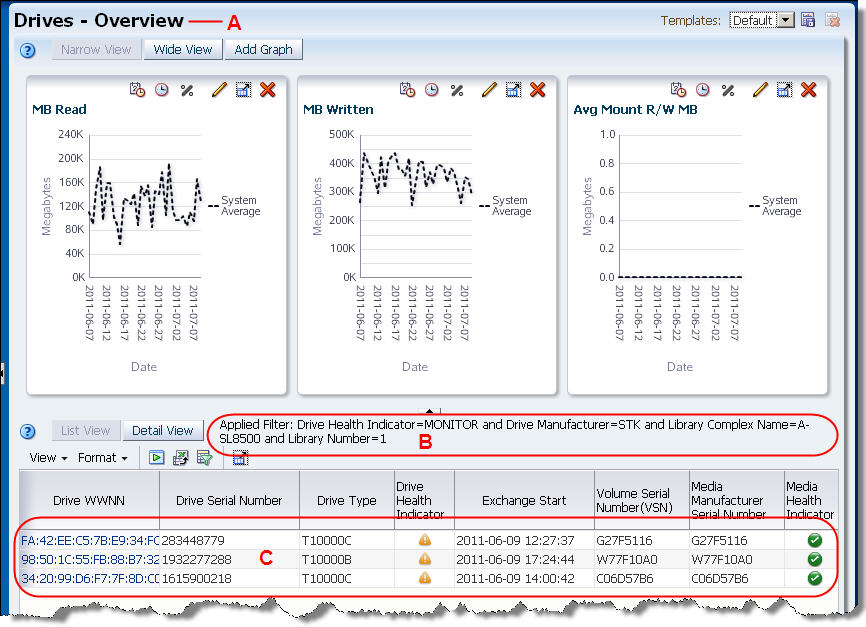

The screen includes a pivot table. In this example, the aggregate count "3" in the highlighted cell represents three StorageTek drives in library "1", within complex "A-SL8500", that all have a health indicator of "MONITOR".
Click the highlighted link.
You are taken to the Drives – Overview screen, which displays additional detail for the three drives.
B – Table filter description is updated to reflect the filter criteria represented by the aggregate count on the Drives – Analysis screen. See the STA User’s Guide for details on the table filter description.
C – The three drives included in the aggregate count are shown in the data table.
Click any of the text links in the Drive WWNN column to display complete details for an individual drive. At this point, see "Use Links to Navigate" for sample instructions.
