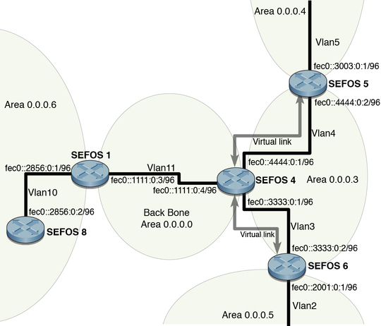

The following figure illustrates this configuration:
IPv6 Example Topology
image:Figure showing sample topology

Virtual Link and Route Summarization Topology
This figure shows the components that are used to test and configure virtual link and route summarization in the example topology.
See IPv6 Example Topology Interface and Host Addresses for the configuration details of this topology.
image:Figure showing virtual link and route summarization topology
