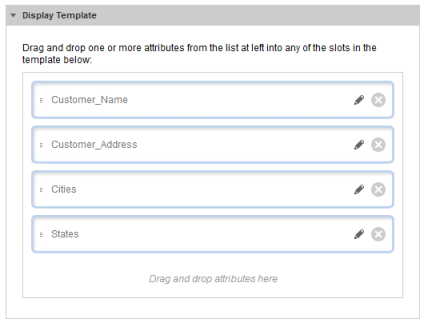

When end users click a location pin or list entry on the Map component, the details for that location are displayed. For each location set, you select the list of attributes to display.
To configure the display of the location details:

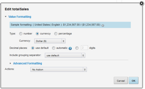

String values do not support additional formatting.
For information on configuring the format of displayed values, see Configuring the format of values displayed on a component.
The available options are:
| Option | Description |
| No Action | Indicates that the attribute value is
not a hyperlink and cannot be used to display details or refine the data.
This is the default value. |
| Enable drill down by refinement on this field | This option only displays if the
attribute can be used for navigation.
If you select this option, then when end users click the attribute value, the data set is refined to only show records with that value. The selected value is added to the Breadcrumbs component on that page. |
| Link to record details | This option is only available for the
top attribute.
