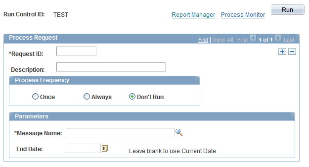

Effective Date Prior Publish Page
Use the Effective Date Prior Publish page (EO_EFFPRIORPUB) to run the Effective Date and Prior Publish utility.
Image: Effective Date Prior Publish page
This example illustrates the fields and controls on the Effective Date Prior Publish page. You can find definitions for the fields and controls later on this page.
Message Name |
Select the current incremental message to publish. |
End Date |
Select the highest effective date to process from the delay table. |
Run |
Click to run this request. |
