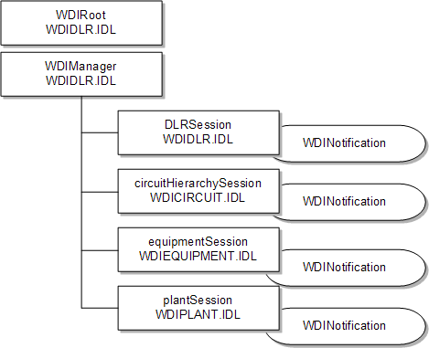

The Plant API consists of the following IDL files:
WDIPlant.idl
WDIPlantTypes.idl
WDI.idl
WDIUtil.idl
Figure 8-1 illustrates the relationship of the Plant API interfaces.
Figure 8-1 Plant API Interface Relationships
