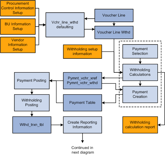

Image: Withholding process flow (part 1)
The following diagrams illustrate the general process flow for withholding in PeopleSoft (the withholding process for your location may differ slightly).
Image: Withholding process flow (part 2)
The following diagrams illustrate the general process flow for withholding in PeopleSoft (part 2).
