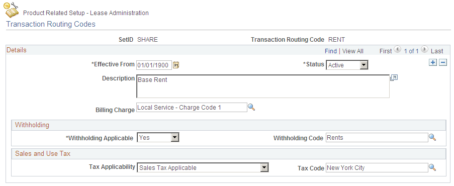

Transaction Routing Codes Page
Use the Transaction Routing Codes page (RE_TXN_ROUTE) to define transaction routing codes.
Image: Transaction Routing Codes page
This example illustrates the fields and controls on the Transaction Routing Codes page. You can find definitions for the fields and controls later on this page.
Details
Withholding Code
Note: Set up supplier information accordingly on the Procurement Control - Withholding page for proper withholding defaults.
See Understanding the Withholding Process.
Sales & Use Tax Default
See Understanding PeopleSoft-Only Sales and Use Tax Processing.
