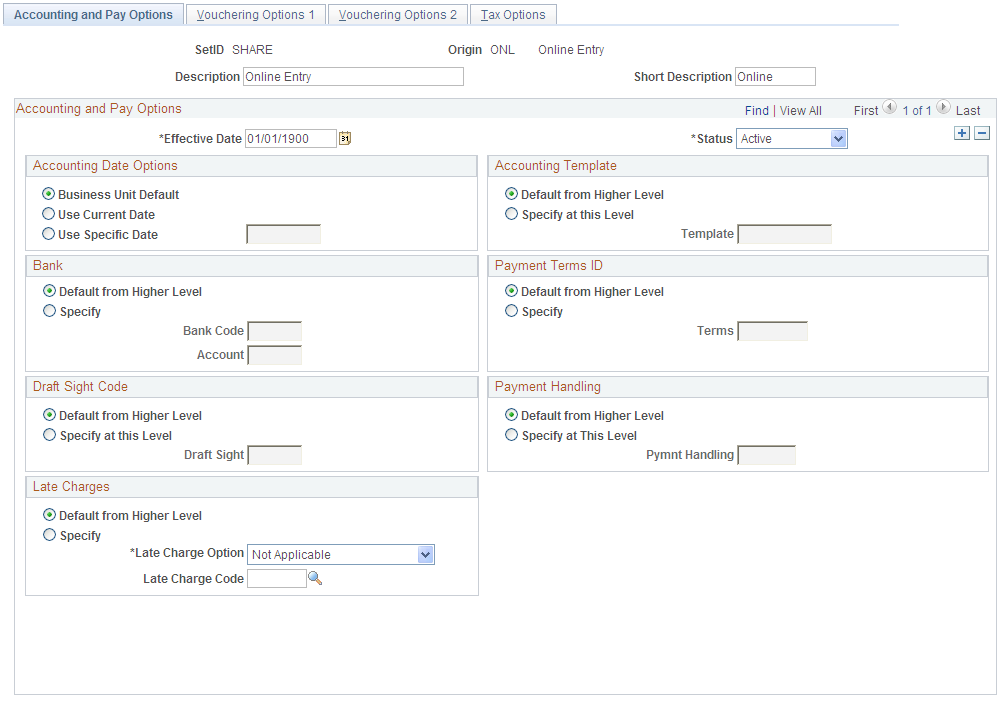

Voucher Origin - Accounting and Pay Options Page
Use the Voucher Origin - Accounting and Pay Options page (ORIGIN_VCHR1) to specify accounting and payment options for the voucher origin.
Image: Voucher Origin - Accounting and Pay Options page
This example illustrates the fields and controls on the Voucher Origin - Accounting and Pay Options page.
The options on this page are the same as those defined in the Payables Definition component (BUS_UNIT_TBL_AP) and the Payables Options component (BU_CTLB). In the Payables Options and Definitions components, you define these options for the business unit; here, you define them for the voucher origin.
Note: The group boxes and fields that appear for a particular origin depend on the options you have enabled. Not all page elements appear for each origin.

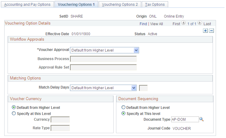

Voucher Origin - Vouchering Options 1 Page
Use the Voucher Origin - Vouchering Options 1 page (ORIGIN_VCHR2) to specify voucher approval, match delay days, voucher currency, and document sequencing settings for the voucher origin.
Image: Voucher Origin - Vouchering Options 1 page
This example illustrates the fields and controls on the Voucher Origin - Vouchering Options 1 page.
The options on this page are the same as those defined in the Payables Options component. In the Payables Options component, you define these options for the business unit; here, you define them for the voucher origin.

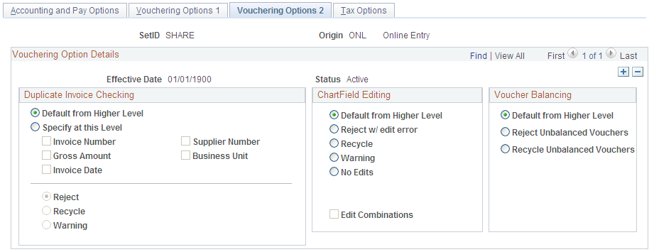

Voucher Origin - Vouchering Options 2 Page
Use the Voucher Origin - Vouchering Options 2 page (ORIGIN_VCHR4) to specify duplicate invoice checking, ChartField editing, and voucher balancing processing settings for the voucher origin.
Image: Voucher Origin - Vouchering Options 2 page
This example illustrates the fields and controls on the Voucher Origin - Vouchering Options 2 page.
