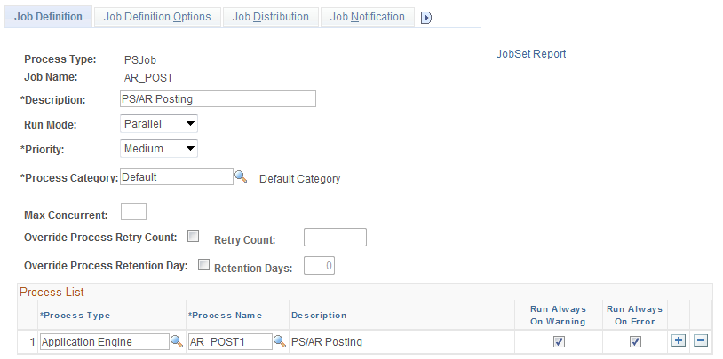

Adding More Parallel Processes to the AR_PGG and AR_POST Multiprocess Jobs
Use the Job Definition page (PRCSJOBDEFN) to add Pending Group Generator and Posting process definitions to the AR_PGG and AR_POST multiprocess jobs.
Image: Job Definition page
This example illustrates the fields and controls on the Job Definition page.
Job Definition page
See also the product documentation for PeopleTools: PeopleSoft Process Scheduler.
