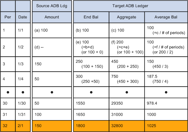

This table shows how the system calculates February 1 for a YTD (year to date) period.
Incremental Calculation for YTD
The following table shows how the system performs incremental year to date calculations:
Image: Year to date example: February 1 is the 32nd day of the period
Year-to-Date Example: Incremental ADB Calculation

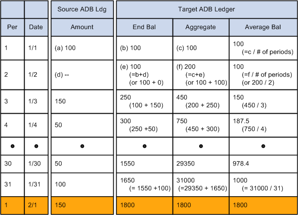

Incremental Calculation for MTD
ADB for the month-to-date (MTD) should not include the ending balance for the prior period as the beginning balance for the current period. MTD is for the month only and the calculation does not include any amounts from any other period.
The following table shows how the system calculates February 1 for a MTD (month to date) period:
Image: Month to date example: February 1 is the first day of the second period
Month-to-Date Example: Incremental ADB Calculation

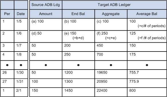

This table shows how the system calculates average daily balances for a date-to-date period type (DTD), starting January 5 through the request date of February 1. The ADB ledger uses a monthly calendar.
Calculation Using a DTD Period Type
This table shows incremental day-to-day calculations:
Image: Incremental day to day calculations
Incremental Day-to-Day ADB Calculations
In this case, even though February 1 is in the next period, the system still uses the previous day's ending balance and aggregate amount in the calculation.
