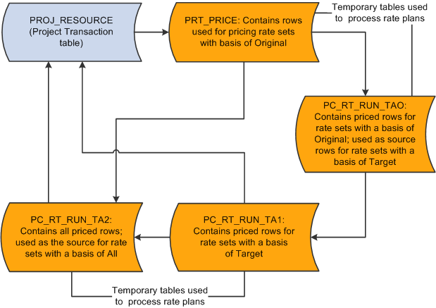

Image: Tables that the system uses to process rate plans
This diagram shows the tables that the system uses to process rate plans:
Source rows that enter PeopleSoft Project Costing from feeder systems are stored in a Project Transaction subrecord (PROJ_RES_TMP) and copied into the PRT_PRICE temporary table.
