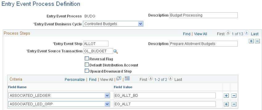

Entry Event Process Definition Page
Use the Entry Event Process Definition page (EE_PROCESS_STEP) to view a predefined series of steps that are grouped by a process for similar processing.
A step is predefined for each transaction type that the process includes. The entry event processor runs each step within the process. Do not modify these steps. BUDG and PCBUDG processes are exceptions. See the previous table titled PeopleSoft Products That Use Entry Events for details.
Image: Entry Event Process Definition page
This example illustrates the fields and controls on the Entry Event Process Definition page. You can find definitions for the fields and controls later on this page.
Note: The PeopleSoft system delivers the entry event processes and steps with your products in the sample data. However, you can add, update, and correct processes and steps using this page.

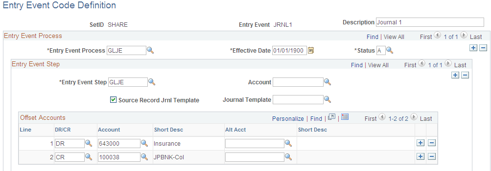

Entry Event Code Definition Page
Use the Entry Event Code Definition page (EE_EVENT_CODE_DEFN) to define entry event codes that are selected or entered into the application's detail distribution lines as part of an accounting transaction.
Image: Entry Event Code Definition page
This example illustrates the fields and controls on the Entry Event Code Definition page. You can find definitions for the fields and controls later on this page.
Note: If an entry event code is copied from one document to other documents, it must be defined as a valid code for the entry event process associated with each type of document. For example, if an entry event code is entered into a PO that can be copied to a voucher, the entry event code definition must include the entry event process for the PO and the entry event process for the voucher. If the code is not defined for both, a processing error occurs due to an invalid entry event code.
