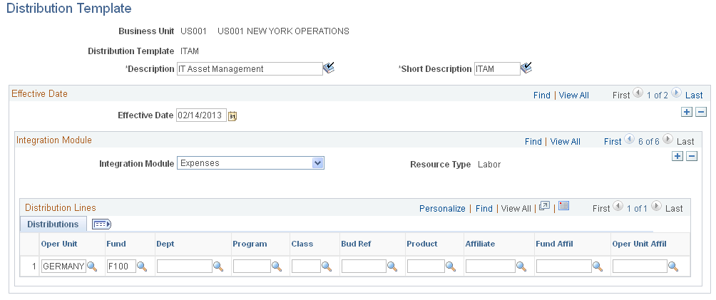

Distribution Template Page
Use the Distribution Template page (WM_DIST_TMPL) to define default ChartField values for Inventory, PeopleSoft Purchasing/PeopleSoft Payables, Expenses (labor only), and PeopleSoft Project Costing (tools) by work order business unit for actual transactions that are initiated via a work order.
Image: Distribution Template page
This example illustrates the fields and controls on the Distribution Template page. You can find definitions for the fields and controls later on this page.
Integration Module
Set up a template for each product (PeopleSoft Inventory, Payables/PeopleSoft Purchasing, and PeopleSoft Expenses), as well as a template for tools using the PeopleSoft Project Costing Integration Module.
Distribution Lines
Configure the distribution lines for each integration module based on these rules:
  • For PeopleSoft Inventory:
    • Users can configure only one distribution line.
    • The PeopleSoft Inventory transaction group associated with the ChartField distribution is not shown on the page because PeopleSoft Inventory uses transaction group 231 exclusively for Maintenance Management. This is the default value for all PeopleSoft Inventory transactions related to PeopleSoft Maintenance Management.
    • Users cannot blank out the default fields that were set up in the PeopleSoft Inventory Accounting Rules Template.
  • For Payables/Purchasing:
    Users can enter multiple distribution lines and specify the percentage of costs or quantity to allocate to each row. Your choice of Quantity or Amount determines the default values that appear in the PeopleSoft Purchasing schedule row of the work order task. You can modify these values prior to staging the purchase order or requisition schedule row.

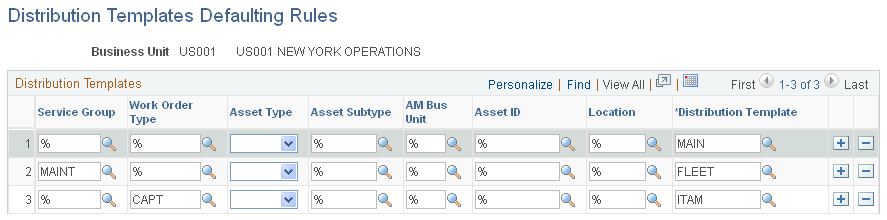

Distribution Templates Defaulting Rules Page
Use the Distribution Templates Defaulting Rules page (WM_DIST_TMPL_BY_BU) to enables users to associate distribution templates with a combination of criteria, such as service group, work order type, asset location, asset type, and more.
Image: Distribution Templates Defaulting Rules page
This example illustrates the fields and controls on the Distribution Templates Defaulting Rules page. You can find definitions for the fields and controls later on this page.
You can add multiple rows containing different values.
