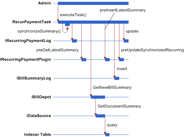

Figure 15 shows the synchronization.
Figure 15. Recurring Payment Synchronization
Synchronization follows these steps:
- RecurPaymentTask.executeTask() is called when the job runs, which calls RecurringPaymentTask.synchronizeSummary().
- RecurringPaymentTask.synchronizeSummary() is called. This method does the real work of synchronization and following are the actions taken in this method.
- IRecurringPaymentLog.getRecurringPaymentsToBeSynchronized() is called to get a list of recurring payments to be synchronized. The query result is affected by the recurring payment job configuration parameter When to Synchronize Recurring Payment with Oracle. When this configuration is Whenever job runs, all the recurring payments are retrieved from the recurring_payments table with payee_id as the job DDN and status as active. If Only after current bill is scheduled is selected, then all payments with the payee_id as job DDN and status as active" and bill_scheduled as Y are retrieved from the recurring_payments table.
- For each recurring payment, IRecurringPaymentPlugIn.preGetLatestSummary() is called. This method allows the recurring payment plug-in code to decide whether to retrieve bills for a particular recurring payment based on biller-specific business rules.
- Call RecurPaymentTask.updateRecuringPaymentOnly() if the plug-in rejects this recurring payment by returning PRE_GET_LATEST_SUMMARY_REJECT. This method performs these functions:
- Update last_process_time to the current time.
- If the recurring payment pay date is fixed date (monthly/quarterly/weekly) and pay amount is based on (minimum) amount due, and no bill arrives for this pay period (bill_scheduled is Y and current time is after the current next_pay_date), then the last_pay_date is updated to current next_pay_date. This ensures that if no bill arrives for this pay period, then the next bill will be paid on the correct date.
- Call IRecurringPayment.update(): this method calculates the next_pay_date based on the current last_pay_date.
- Call IBillDepot.getNewBillSummary(). This interface is implemented by com.edocs.payment.imported.eadirect.BillDepot. The BillDepot class retrieves the latest bill summary for the specified account.
- BillDepot.getNewBillSummary() is called, which then calls BillDepot.getSummary().
- BillDepot.getSummary() is called. This method calls IDataSource.getDocumentSummary() to get all the bills indexed for this account between the last_process_time of the recurring payment and the current job run time.
- The returned bills are in the format of name value pairs with value of string. They are interpreted to retrieve due date, amount due, and the minimum amount due.
- For each bill, if minimum amount due is not null, then call BillDepot.preParseMinAmountDue() to give a child class of BillDepot (through the plug-in) a chance to manipulate the minimum amount due string before it is parsed, then it parses min amount due.
- If the bill's amount due is not null, call BillDepot.preParseAmountDue() to give child class of BillDepot (through the plug-in) a chance to manipulate the amount due string before it is parsed, then it parses the amount due. If the amount due fails to parse, then the bill is ignored.
- If the bill has no amount due, or its amount due is set to null by preParseAmountDue(), or the amount due failed parsing, then the bill is ignored.
- If the bill due date is not null, call BillDepot.preParseDueDate() to give child class of BillDepot (through the plug-in) a chance to manipulate the due date string before it is parsed, then it parses the due date.
- If the bill has no due date, or its due date is set to null by preParseAmountDue(), or the due date failed parsing, then the bill is ignored.
- All the successfully parsed bills are compared with the bill summary associated with the current recurring payment, if the summary is not null. The following business rules are used to decide which bill is the latest one:
The due dates of the bill summaries retrieved are compared and the one with latest due date is chosen.
For rebill, multiple bills with the same due date can be retrieved. In this case, a rebill is chosen based on the following rules: the one with latest Doc Date and in case of the same Doc Date, the one with the larger IVN number. This assumes that a rebill is indexed after its original bill. A rebill will be ignored if its original bill has been paid (the bill_scheduled flag of recurring payment is Y).
- BillDepot.Summary() returns the latest bill if there is one found. Otherwise, it returns null.
