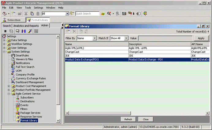

  1. Log in to Java Client, with Admin privileges and select Admin > System Settings > Agile Content Service > Format Library. The Format Library window appears.

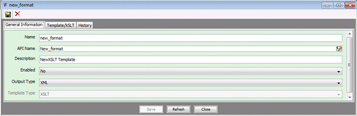

  4. Click OK.
    The Format Library window displays the newly created format.
    Figure 5-5 The newly created format
    Surrounding text describes Figure 5-5 .

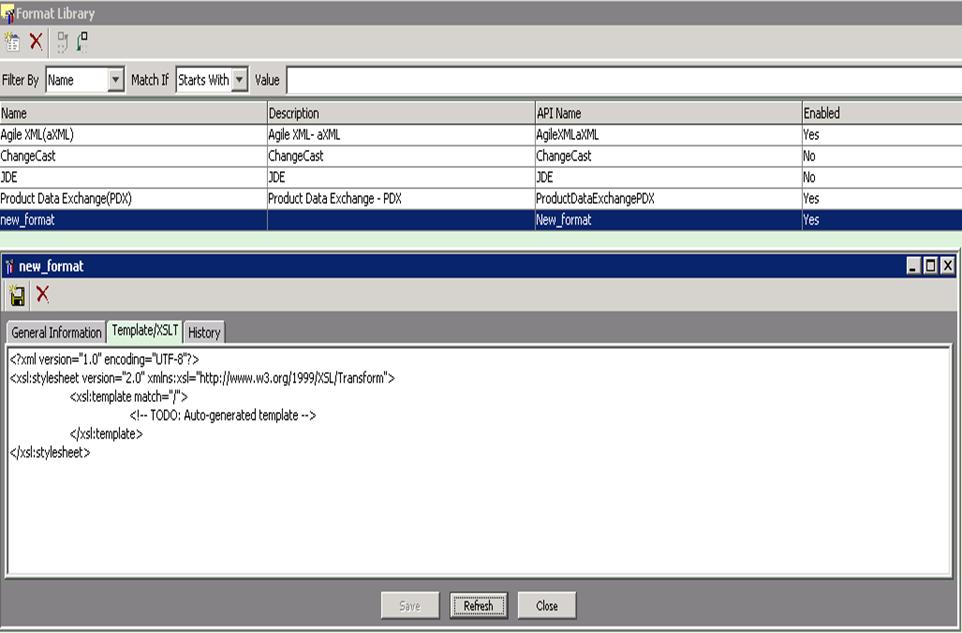

  5. In new_format, enable this format and then select the Template/XSLT tab.
  6. Copy and paste the contents of XSLT in Template/XSLT page.
    Figure 5-6 new_format in Format Library

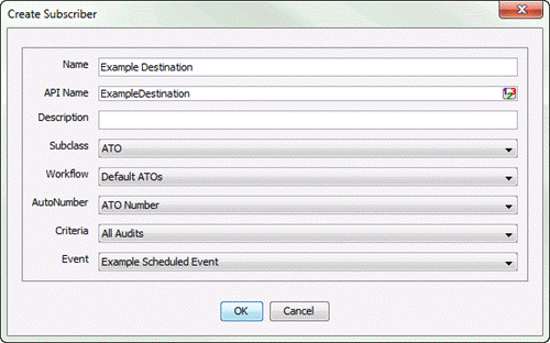

  7. Select Agile Content Service > Subscribers > the New button. The Create Subscriber dialog appears.
  8. In Create Subscriber dialog, define a new destination and call it Example Destination and then click OK.
    Figure 5-7 The Create Subscriber dialog
    Surrounding text describes Figure 5-7 .

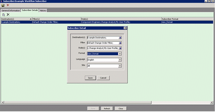

  9. Select Agile Content Service > Subscribers > Example Destination > Add button.
    Figure 5-8 The Subscriber Detail dialog
    Surrounding text describes Figure 5-8 .
  10. Select new_format when setting Subscriber Details for this subscriber.
    The ACS subscriber will export the product data in the new format.
