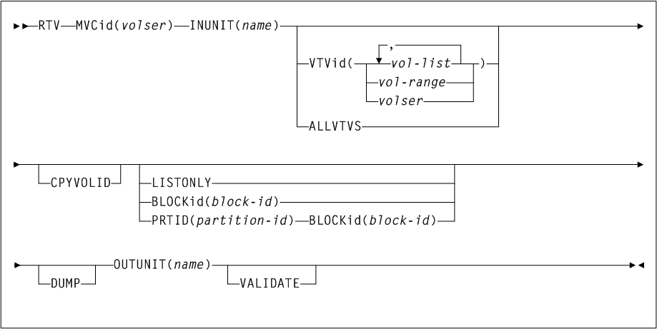

Figure 6-1 shows RTV utility syntax.
Figure 6-1 RTV utility syntax
Surrounding text describes Figure 6-1 .
Parameters
As shown in Figure 6-1, the RTV utility includes the following parameters:
MVCid
specifies the MVC that contains the VTVs that RTV converts to volume(s) which become real tape versions of the VTVs.
volser indicates the MVC volser.
INUNIT
specifies the name to use to allocate the input tape unit. You can specify an MSP unit address, an esoteric name, or a generic name. The valid values are the same as for the UNIT= JCL parameter.
name indicates the unit name.
VTVid
optionally, specifies one or more VTVs to convert.
volser, vol-range, or vol-list indicate the volsers of one or more VTVs.
ALLVTVS
optionally, convert the most current copy of all VTVs on the specified MVC. That is, if there are multiple copies of a VTV on the specified MVC, RTV only converts the most current copy of the VTV.
VTVid and ALLVTVS are mutually exclusive.
CPYVOLID
optionally, copy the VTV internal volser from the VTV to the output volume VOL1 record. The default is to not copy the internal volser.
Caution:
Use the CPYVOLID parameter carefully! The volser of the output tape will be changed to the volser of the VTV. If the output tape has an external label or if the output is directed to another VTV, this will cause label mismatches and can cause unpredictable and undesirable results.
  • If the output tape is non-labeled or has a non-standard tape label, CPYVOLID will be automatically specified for this VTV decompression, and a standard label tape will be created on the output device.
  • RTV supports VTVs created with standard or ANSI labels. If you do not specify CPYVOLID, RTV processes these label types as described in Table 6-1. This only applies to the VOL1 record. The HDR1/HDR2 labels are always copied from the VTV by RTV for every VTV processed.
The following table lists RTV label types:
Table 6-1 RTV Label Types
VTV Label Type Output Standard Label Output ANSI Label Output Non-Label
Standard label
VOL1 label not copied
WTOR issued
VOL1 label is copied
ANSI label
WTOR issued
In Table 6-1, the WTOR is as follows:
SWSRTV - Label mismatch - Reply RELABEL, RETRY, or CANCEL
The operator responses produce the following results:
  • RELABEL specifies to decompress the RTV and overwrite the volser on the output volume.
  • RETRY specifies to mount another output volume and retry the operation.
  • CANCEL specifies to not decompress the RTV.
LISTONLY
optionally, lists (but does not convert) the VTVs on the specified MVC. For more information, see "RTV LISTONLY Listing".
BLOCKID
optionally, specifies the logical block ID where the VTV begins on the MVC.
block-id is the logical block ID (8 hexadecimal characters).
  • BLOCKID and LISTONLY are mutually exclusive. In addition, if you specify the ALLVTVs parameter, or if a list or range of VTVs is specified, the BLOCKid parameter is ignored.
  • Not specifying a BLOCKid value can cause very long execution times with high capacity media. The BLOCKid is used for high speed positioning to a VTV on the MVC.
  • The LISTONLY parameter listing on ”RTV LISTONLY Listing” on page 777 supplies a Block ID value that you can use as input to the RTV utility to convert a VTV to a volume.
PRTID
optionally, specifies the partition id of the VTV being recovered from a partitioned MVC.
partition-id is the hexadecimal partition ID.
  • If PRTID is specified, BLOCKid must also be specified.
  • PRTID and LISTONLY are mutually exclusive. In addition, if you specify the ALLVTVs parameter, or if a list or range of VTVs is specified, the BLOCKid parameter is ignored.
DUMP
produce a S0C3 abend dump if RTV cannot decompress a VTV. If you specify DUMP, create a SYSMDUMP DD JCL statement to capture the dump.
OUTUNIT
the name to use to allocate the output tape unit. You can specify an MSP unit address, an esoteric name, or a generic name. The valid values are the same as for the UNIT= JCL parameter. This parameter is required if you do not specify LISTONLY.
name is the unit name.
VALIDATE
Validates that the RTV utility can successfully process the specified VTV(s) without creating an output tape.
