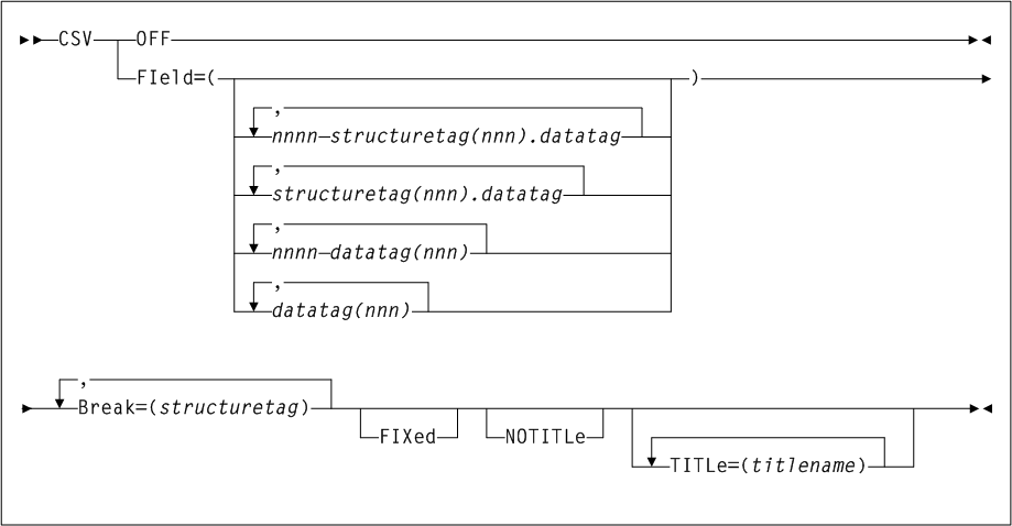

The CSV
command controls CSV output processing.
Each CSV
command contains a list of CSV element definitions separated by commas. Each CSV element definition specifies an XML data tag name with optional XML structure tag and subscript values. Refer to the ELS Programming Reference for more information about ELS XML tags.
Syntax:
Parameters:
Disables CSV processing for subsequent requests.
OFF
is mutually exclusive with all other CSV parameters.Required if OFF
is not specified.
nnnn-
is an optional field name prefix containing 1 to 4 numeric characters followed by a dash. When a field name is prefixed by "n(nnn)-
", the CSV output for the field always contains exactly the number of characters specified. Numeric fields are right-justified with the most left-most digits truncated; other fields are left-justified with the right-most characters truncated. If the value specified is longer than the actual value, it is padded with blanks on the left for numeric fields and blanks on the right for other fields.
For example:
8-acs_status
truncates the acs_status
value to 8 characters.
12-acs_status
blank-pads the acs_status
value to 12 characters.
The maximum value of nnnn
is 1024. The specification of "nnnn-
" is valid only when the parameter FIXed
is also specified.
structuretag(
nnn
.datatag
is an optional XML structure tag and data tag pair. An XML structure tag is an element that contains other elements but does not have content value. Refer to the ELS Programming Reference for more information about ELS XML tags.
Specify an XML structure tag/data tag pair only when the data tag occurs within multiple structure tags. For example, the DISPLAY LSM
request data tag free_cell_count
is used under the structure lsm_data
to contain the total LSM free cell count and under the structure panel_data
to contain the panel free cell count. Specifying lsm_data.free_cell_count
requests the free cell count from the lsm_data
structure; specifying panel_data.free_cell_count
requests the free cell count from the panel_data
structure. If no structure tag is coded for a data tag that occurs under multiple structure tags, the first occurrence of the data tag in the generated XML is used.
nnn
is an optional subscript that determines how many of the multiple XML data values are included in the CSV output.
Specify a subscript only when the structured XML data for a single request contains multiple XML structure elements with the same name. This is indicated in the requestXML description whenever the column labeled "Maximum Occurrences
" is greater than 1. A subscript value can be specified in BOTH the structure tag name AND the data tag name, for example:
CSV FIELD=(mvc_instance(4).volser,+ mvc_instance(4).partition_id(2))
creates CSV output with 12 fields, four mvc_instance
volser occurrences, followed by two fields representing the partition_id
values associated with the first MVC volser, then two fields representing the partition_id
values associated with the second MVC, and so on.
datatag(
nnn
is an optional XML data tag. If a data tag does not under more than one structure tag in a request, it is not necessary to specify a structure tag qualifier.
nnn
The XML tag names are NOT case-sensitive and can be specified in any combination of upper and lowercase characters.Required if OFF
is not specified. The break tag must be a valid structure tag defined for the input request. Whenever a trailer tag matching the break tag is found in the output process, a new CSV record is created. Examples of valid break tags are:
For DISPLAY CDS
, cds_data
or host_data
For VOLRPT
or Display Volume
, volume_data
Generates fixed format CSV output. Each field in the CSV output is blank-padded so that it occupies a fixed number of characters. You can use his option to create a customer-specified format flat file for reporting.
Specifies that no CSV title line is produced. If this keyword is omitted, the first line of each CSV request is a title line containing comma separated tag names.
If TITLe
is specified, the title names specified are used in the title output line in place of the XML tag names. For any omitted title name, the specified XML tag name from the FIELD
parameter is used in the title.

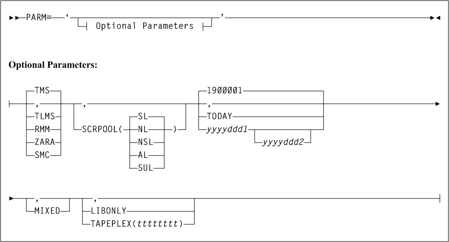

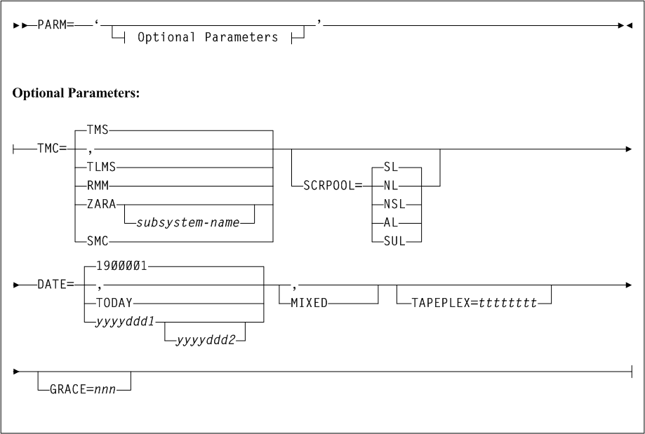

The following section describes the syntax and parameters for keyword format of the PARM
parameter.
If you use the keyword format, adhere to the following syntax rules:
Keywords and values must be separated by "=" (except for the MIXED
keyword, which does not have a value).
Extraneous commas between keywords are not allowed. For example, the following is invalid: PARM='TMC=TMS,,MIXED'.
Duplicate keywords are not allowed.
Valid parameters include the following:
specifies that the parameters that follow can be accessed by the program indicated in the PGM
parameter in the JCL.

optionally, specifies the tape management system. For example:
TMS
specifies the CA-1 tape management system (TMS). This is the default.
TLMS
optionally, specifies the TLMS: CA-DYNAM/TLMS tape management system.
RMM
optionally, specifies the DFSMSrmm tape management system.
SMC
optionally, specifies the extract file from the SMC utility SMCUDBX
If SMC is specified, label and date parameters are not permitted. (Label and date selection are performed by the SMC utility when it creates the extract file.)
ZARA
optionally, specifies the ZARA tape management system.
subsystem-name
is an optional subsystem name.
optionally, specifies the scratch pool label type used by the library. Valid label type values are:
(SL)
indicates standard label (the default).
(NL)
indicates non-labeled.
(NSL)
indicates non-standard label.
(AL)
indicates ANSI label.
(SUL)
indicates standard user label
optionally, specifies the date or date range when a volume became scratch in the TMC.
1900001
optionally, specifies January 1, 1900 as the date. This is the default.
TODAY
optionally, indicates the current system date. Only volumes placed in scratch status on this date are processed.
yyyyddd1
optionally, the "from" date. The "to" date defaults to the current system date. All specified dates are in Julian notation.
All volumes placed in scratch status starting on day yyyyddd1
through today's date are processed.
yyyyddd1-yyyyddd2
optionally, the date range in which the volumes became scratch. Neither of these dates can be greater than the current system date.
through day yyyyddd2
are processed.
optionally, specifies to print all the headings and messages in mixed case characters (uppercase and lowercase characters).
If a comma is specified, or if this keyword is not specified, the system defaults to uppercase letters.optionally, specifies the name of an SMC TapePlex to be used to extract CDS volumes and run UUI scratch commands.
tttttttt
is the TapePlex name.
The specified TapePlex may be a local HSC executing on the same host as SLUCONDB
, or may be an HSC subsystem on another host accessed through the SMC client server feature. Specifying the TAPEPLEX
parameter requires an active SMC system on the SLUCONDB
host, an active HSC system for the TapePlex, and requires that SLUCONDB
be executed from an APF-authorized library.
optionally, specifies a grace period (in hours) for scratch eligibility. A volume accessed after the start of the SLUCONDB
run, minus the grace period, is not eligible for scratch.
nnn
is a 1-3 digit numeric value from 0 to 999, representing the grace period in hours.
The following section describes the syntax and parameters for positional format of the PARM
parameter.
You must enter parameters in the specified order and include commas for omitted parameters.specifies that the parameters that follow can be accessed by the program indicated in the PGM

The keywords for the PARM
are positional. If you accept the system defaults, either do not specify PARM
, or code ”PARM=

The Scratch Conversion utility uses the UUI to extract volume and VTV records from the CDS. The UUI requires read access to the CDS, either from statements in the JCL or by getting the data set information from an active HSC. TheSLSCNTL
, SLSCNTL2
, and SLSSTBY
DD statements are optional if an active HSC is running on the same system. The SLSCNTL
, SLSCNTL2
, and SLSSTBY
DD statements are not allowed if either LIBONLY
or TAPEPLEX
parameters are specified.the primary control data set. This statement is optional.
the secondary control data set. This statement is optional.
the standby control data set. This statement is optional.

//JOBSCUP JOB (account),programmer //STEP1 EXEC PGM=SLUCONDB, // PARM=('TLMS,,,MIXED') //STEPLIB DD DISP=SHR,DSN=your.sea.smp/e.loadlib //SLSTMS DD DSN=TMS.MASTER.FILE,DISP=SHR //SLSSOUT DD DSN=&&SCUPINPT,DISP=(NEW,PASS), // UNIT=,SPACE=,DCB= //SLSPRINT DD SYSOUT=* //* //STEP2 EXEC PGM=SLUADMIN,COND=(4,LT,STEP1),PARM=MIXED //SLSIN DD DSN=&&SCUPINPT,DISP=(OLD,DELETE) //SLSPRINT DD SYSOUT=* //
Example 5-5 JCL to Process TMS Database with HSC CDS DDnames
//JOBSCUP JOB (account),programmer //STEP1 EXEC PGM=SLUCONDB, // PARM=(',,2009100-2009110,MIXED') //STEPLIB DD DISP=SHR,DSN=your.sea.smp/e.loadlib //SLSTMS DD DSN=TMS.MASTER.FILE,DISP=SHR //SLSSOUT DD DSN=&&SCUPINPT,DISP=(NEW,PASS), // UNIT=,SPACE=,DCB= //SLSPRINT DD SYSOUT=* //SLSCNTL DD DSN=primary.control.dataset,DISP=SHR //SLSCNTL2 DD DSN=secondary.control.dataset,DISP=SHR //SLSSTBY DD DSN=standby.control.dataset,DISP=SHR //* //STEP2 EXEC PGM=SLUADMIN,COND=(4,LT,STEP1),PARM=MIXED //SLSIN DD DSN=&&SCUPINPT,DISP=(OLD,DELETE) //SLSPRINT DD SYSOUT=A //
