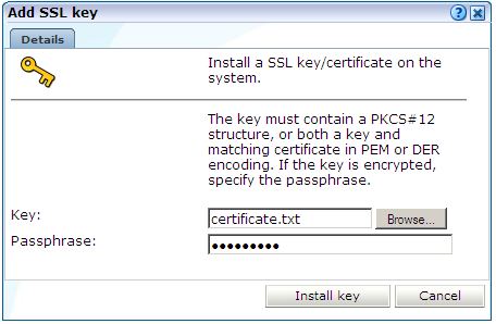

RUEI can be configured to monitor encrypted data (such as HTTPS and SSL). In order to do this, a copy of the web server's private SSL keys needs to be imported into RUEI. To import certificates to monitor encrypted content, do the following:
Select Configuration, then Security, then SSL keys, and then SSL keys management. Use the Profile menu to select the required Collector profile. A list of the currently installed keys is displayed. An example is shown in Figure 13-18.
Click Add new key to define a new key. Note that existing SSL key definitions cannot be modified. The dialog shown in Figure 13-19 appears.
Use the Key field to specify the file containing the key. If the key is encrypted, you must specify the passphase. When ready, click Install key.
The supplied file can be in PEM, DER, or PKCS12 format, and must include the key and matching certificate. The key must be an RSA key. Note that encryption protocols that use 40-bit keys (such as DES_40, RS2_4-0, and RC4_40) are not supported.Supported Encryption Protocols and Mechanisms

Private Key Extraction Failures
Be aware that if the loading of a private key fails, this can be due to a number of possible reasons, including an incorrect password or the file containing the certificate and private key is corrupted.
To remove an installed SSL key, right click the required key, and select Remove. You are prompted to confirm the key's removal.

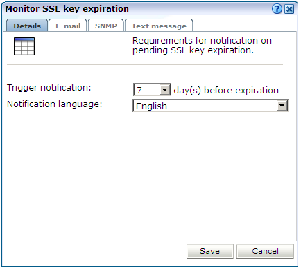

Optionally, you can configure notifications about pending SSL key expirations. This allows you to plan the importation of new keys, and ensures that there are no gaps in the monitored data while new keys are obtained and activated. Do the following:
Click the Monitor key expiration icon on the taskbar. If it is not already visible, select Configuration, then Security, then SSL keys, and then SSL keys management. The dialog shown in Figure 13-20 appears.
Specify the number of days prior to expiration when notification should be generated. Use the controls on the other tabs to specify the e-mailing, SNMP, and text message notification details. These are similar to the dialogs explained in Section 7.5.1, "Alert Profiles". When ready, click Save.
When a required restart is indicated, restart the Collectors assigned to the profile. This is described in Section 13.1.5, "Restarting Collectors".
The check for expired SSL keys is scheduled to be run once a day at 6 am (Reporter system time).The RUEI installation can be configured to omit the logging of sensitive information. This is called masking, and it allows you to prevent passwords, credit card details, and other sensitive information from being recorded on disk.
