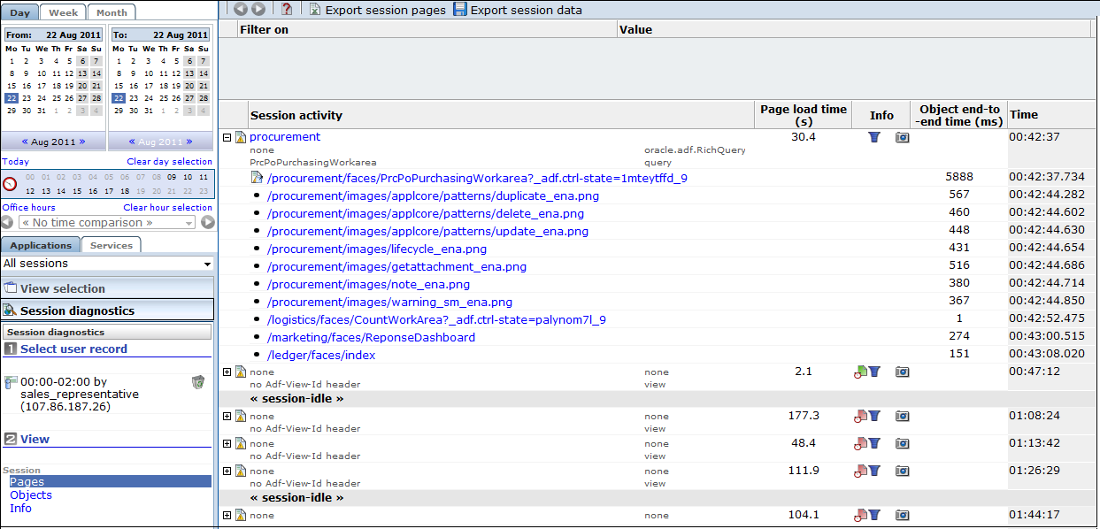

  5. After selecting a user record, the View part of the panel in the left-hand side of the window allows you to view information about the selected user record. Use the Pages, Object, and Info items under the Session part to view information concerning specific aspects of the selected user record. An example is shown in Figure 4-3.
    Figure 4-3 Example Diagnostics Panel
    Description of Figure 4-3 follows
    Description of "Figure 4-3 Example Diagnostics Panel"

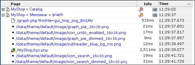

    Session pages are grouped so that when expanded their associated objects can be viewed. The overview shows the pages and actions (and their times) recorded within the selected user record. Icons indicate slow or failed objects, page loading satisfaction, whether the pages are key pages, and whether replay content for them is available. The use of the Replay viewer is described in Section 4.2, "Replaying User Sessions".
    Note you can use the Include/Exclude spurious objects icon within the toolbar to control whether hits not directly associated with a reported page are included in its displayed list of objects. This facility is particularly useful in the identification of problem objects that have an extremely long load time. Normally, these objects would not have associated pages and, therefore, would not be listed in the session page report.
    The Export session pages command button allows you to export a summary of the currently selected user record to Microsoft Excel. The use of this facility is explained in Section 4.3, "Exporting Session Pages to Microsoft Excel".

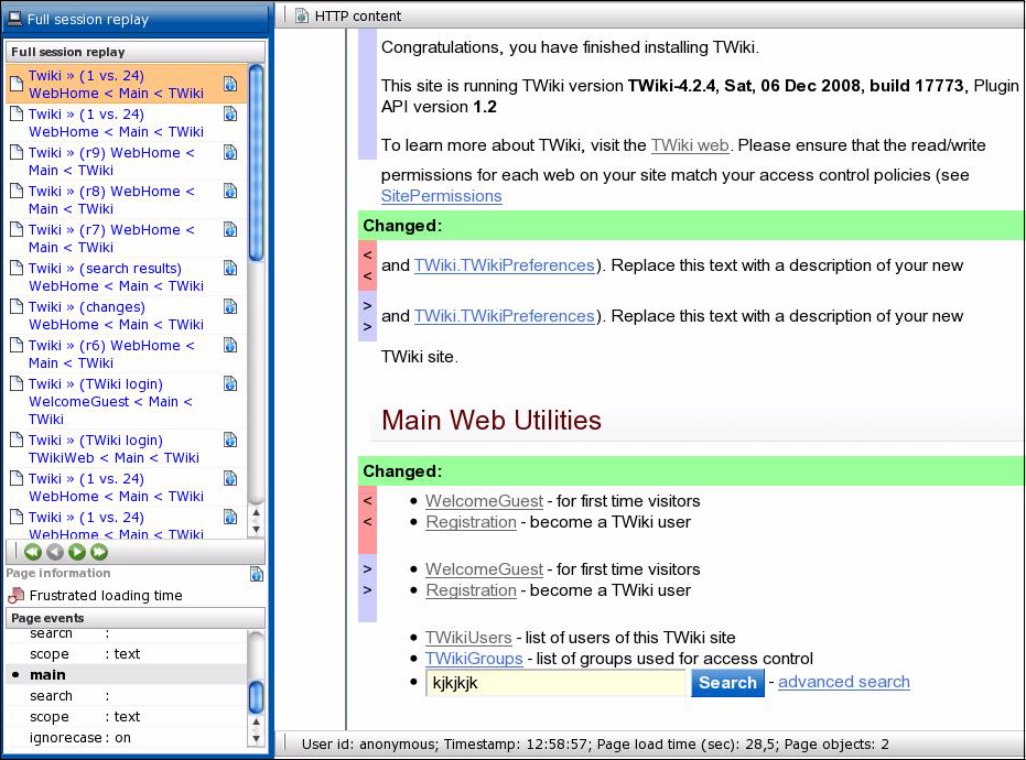

When available, you can click the Replay icon beside a viewed page to replay the complete user session. This provides the opportunity to review each page viewed by the visitor during the session, together with any reported error messages. An example is shown in Figure 4-7.
Figure 4-7 Example Session Replay
Description of Figure 4-7 follows
Description of "Figure 4-7 Example Session Replay "
The replay details are shown in a new window which is the same size as the main window. Note that if selected by clicking the Replay icon for a page within a selected user record, the displayed page history starts from the point of the selected page.
The controls below the page listing allow you to navigate through the page history. The Page information section indicates the currently highlighted page's loading satisfaction, whether it is key page, and whether it contains an error.
Reporting Page Events
If a viewed page contained HTTP form elements, these and the visitor replies are reported in the Page events panel. Unnamed elements are reported as "NO_NAME_number" (where number is incremented for each unnamed element). Hidden form elements are also reported. Be aware that the replies made by a visitor to form elements is derived from the request body of the next page in the session page view history. Therefore, if the visitor switched context to another page between the request and response pages, the user response cannot be extracted and reported.
The status bar at the bottom of Figure 4-7 provides information about the session user ID, each page's recorded timestamp, loading time, number of objects and (in the case of static pages) an indication that reported pages are retrieved from the live source (such as the application server).
Viewing Page Content
The HTTP content command button on the toolbar allows you to view the actual request and response content of the currently selected page. An example is shown in Figure 4-8.
Figure 4-8 Example Page Content
Description of Figure 4-8 follows
Description of "Figure 4-8 Example Page Content"
Note that external JavaScript files can also be viewed by clicking the link within the page content. The reported content of these files is retrieved from the live source (for example, an application server).

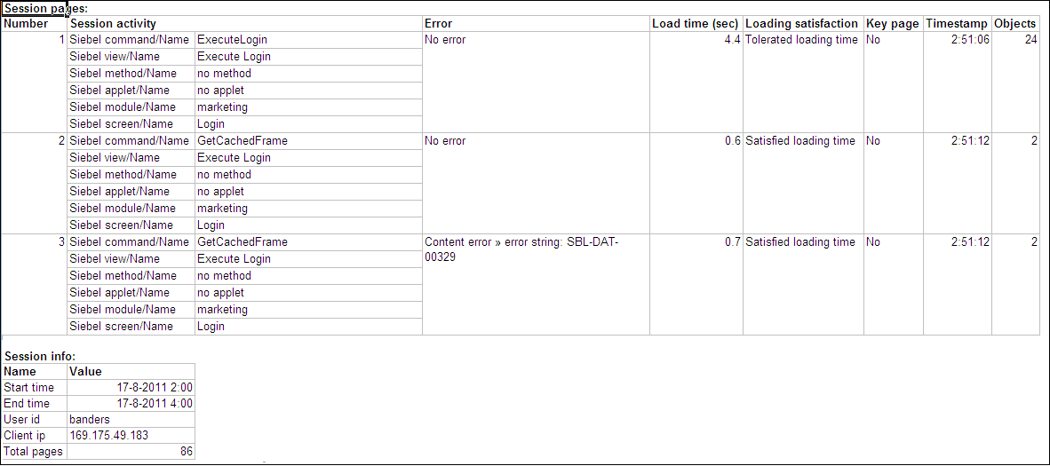

4.3 Exporting Session Pages to Microsoft Excel
You can export a summary of the pages within the currently selected session to Microsoft Excel. To do so, do the following:
  1. Select the required session using the procedure described earlier. Click the Export session pages command button. Depending on how your browser is configured, you are either prompted to specify the tool with which to open the file directly (by default, Microsoft Excel), or it is immediately saved to the defined default location.
  2. Within Microsoft Excel, you can view and edit the generated file. An example is shown in Figure 4-9.
    Figure 4-9 Example Microsoft Excel Session Pages Export
    Description of Figure 4-9 follows
    Description of "Figure 4-9 Example Microsoft Excel Session Pages Export"
The exported page view history and session summary can be used to compile sets of real-user sessions. For example, to be used as the basis for testing or performance analysis.
Controlling Row Creation and Ordering
Be aware that the rows (and their order) that appear in the Microsoft Excel export are based on the currently selected Session Diagnostics dimensions template. This is described in Section 4.5, "Controlling Dimension Listing Within Session Diagnostics".

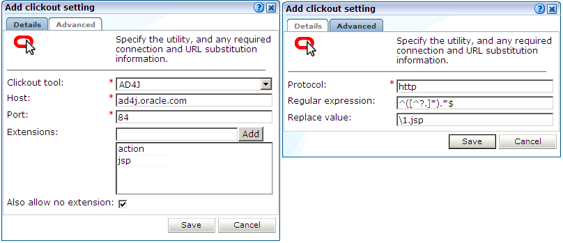

4.6 Configuring Clickouts to External Tools
The URL diagnostics group (described in Section 3.2.2, "Problem Analysis Groups"), the suite diagnostics groups (described in Section 3.2.5, "Suite URL Diagnostics for Problem Analysis"), and Session Diagnostics (described in Section 4.1, "Introduction") support clickout from selected functional URLs and certain dimensions to external diagnostics utilities. The supported external utilities are shown in Table 4-3.
Table 4-3 Clickout Options
Utility Description
Enterprise Manager 12
Depending on your installed Oracle Enterprise Manager middleware and application management packs, the following options can be used:
  • Trace JVM transaction: provides JVM activity information for the selected request based on its ECIDFoot 1 . This option is available through the ECID dimension within the URL diagnostics and problem analysis groups and Session Diagnostics.
  • Trace request: provides aggregated JVM activity information for the selected request. This option is available through the URL dimension within the URL diagnostics group and Session Diagnostics.

Configuring Clickout Functionality
To configure access from within RUEI to these utilities, do the following:
  1. Click the Configuration tab, then General, then Advanced settings, and then Clickout settings. Note that this option is only available to Administrators. Click Add new item or an existing external utility definition. A dialog similar to the one shown in Figure 4-14 appears.
    Figure 4-14 Edit Clickout Setting
    edit clickout settings
  2. Use the Clickout tool menu to select the external utility whose interface you want to configure. The supported utilities are shown in Table 4-3. Note that the other fields available within the dialog depend on the selected utility.
  3. Use the Host field to specify how the selected external utility should be reached. This should not include the protocol scheme (such as http://). For example, ruei-camm.oracle.com.
  4. Use the Port field to specify the required port number. Only one port number can be specified. A wildcard character (*) cannot be specified.
  5. Use the Extensions entry field to specify the object file extensions for which clickout should be available. Use the Add button to specify additional extensions. You can also use the Also allow no extension check box to specify whether hits with no associated file extensions should have clickout availability.
  6. Click the Advanced tab, and use the Protocol field to specify whether HTTP or HTTPS is used for connection to the selected utility. By default, HTTP is used.
  7. Use the Regular expression and Replace fields to specify the parts of the URL passed to the external application that should be replaced. Further information on the use of regular expressions is available from Knowledge Base articles within the My Oracle Support website. This is available at the following location:
    https://support.oracle.com/CSP/ui/flash.html
    When ready, click Save. Any changes made to these settings are applied immediately.

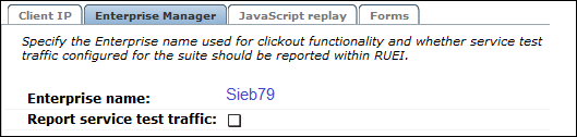

For Oracle E-Business Suite (EBS) and Siebel suites, the Enterprise name must be specified as part of a suite's configuration in order for clickout functionality to be available. This is described in Section 10.1, "Working With Suites".
The defined Enterprise name can be located by selecting the appropriate suite, then clicking the Advanced tab, and then the Enterprise Manager tab. An example is shown in Figure 4-15.
Figure 4-15 Example Enterprise Name
Description of Figure 4-15 follows
Description of "Figure 4-15 Example Enterprise Name"
